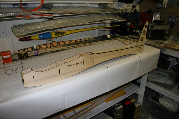

Hi Fred

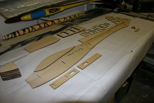

Started the Quark 2m, and so far may I say that this is a great model to build and quick to stick together. I have had no problems yet with the plan except I had to put extra ply at the fuselage joints for strength, this was due to the cnc cutter, I think. I like the new tail design, which saves a lot of time during the building process.
All parts cut out and checked against the plans.
All the formers, lined up perfect except C5, however a little triming and everything was fine.

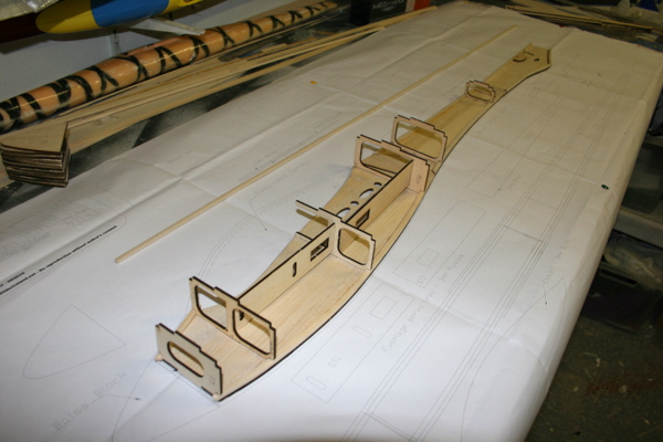

Checking the formers before adding the other fuselage side.
The two sides of the fuselage are now added and supported with rubber bands before any glue is applied. As I said, this is a great model to build, all this done in less than 2 hours WoW!
Less than 2 hours work, i am starting to like this build already!
Next I need to add the top and bottom sheeting and start on shaping the nose, keep you all updated soon!

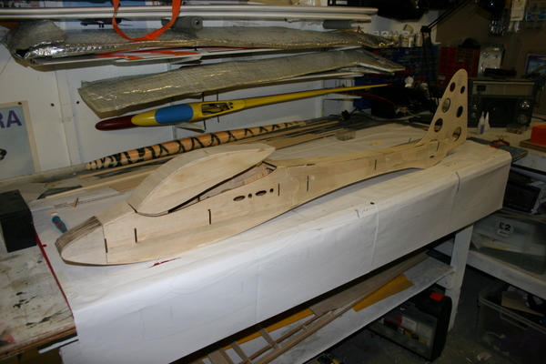

A little more done tonight, between brushing out the workshop of all the water which has ran down from the patio straight in front of the workshop door, handy if I was a marine modeller :lol: . So finished sheeting the front hatch, and added the nose which needs to be sanded to shape.
Fuselage ready for an over all sanding to shape.

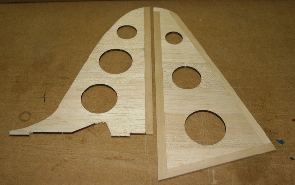

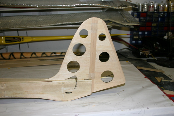

The tail I have is the prototype and Fred has changed this on the plans, However I just used a few strips of hard balsa along the edges of the rudder and fin to make them more rigid see below:
Tail with added strips for strengh
How the tail looks when added to the fuselage.

[quoteThe tail I have is the prototype and Fred has changed this on the plans, However I just used a few strips of hard balsa along the edges of the rudder and fin to make them more rigid see below:
quote]
It’s statements like this that throw me completely off.
When you say you’ve “added some strips of hard balsa along the edges” do you mean;
a) that you have stuck some kind of balsa veneer strips onto the original edges of the rudder & vertical fin? (I’ve never heard of such veneer strips,…but that doesn’t mean such things don’t exist of course.)
Or
b) That you’ve stuck some balsa of the same thickness to the edges of the rudder/fin? (Thereby increasing the surface area of the rudder/fin in the process. Which is what the pictures look like to me.)
This probably sounds a daft question to all you experienced guys, but to a Numpty like me :roll:
