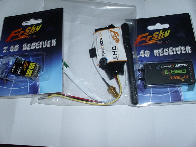

Got home tonight and the bits had already arrived from GiantCod
Here's what was ordered:
1TX telemetry Hack module
1 8 Channel telemetry capable RX
1 4 Channel standard RX
Maplins tomorrow for a small case to put the hack module, aerial & bind switch in, plus a 7 pin DIN plug for the trainer port

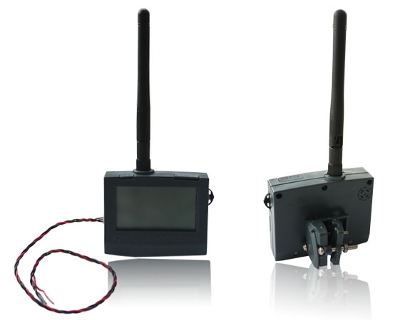

On another note, I'm going to receive this for evaluation :
Hub and sensors are already on the way to me  :D

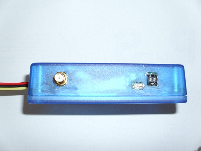

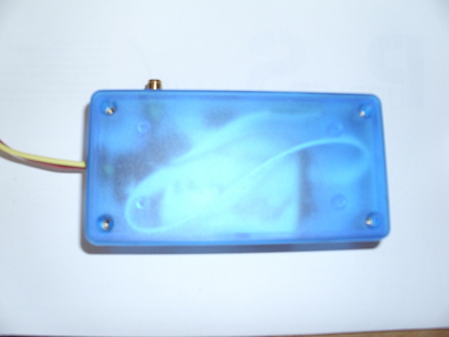

As a result of my emploer trying to shaft us on pension rights and me being on strike today, I got a bit done today:
Here's the module in a case with the aerial conection & bind switch through the side
Now only need to solder on the DIN plug before I can test it
