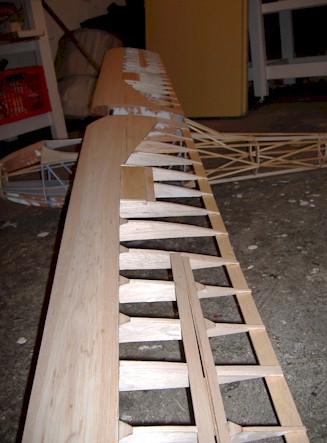

So, the sheeting is the only thing left to do, not before gluing some blocks inside the elevator for the hinges :
And finally, gluing of the "real" LE and sanding :
Et voila !

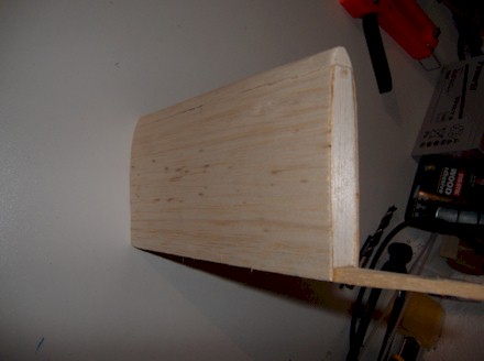

Then, the elevator (mobile one.. don't know the name for that in English.. :o ). The building is like an Aileron, so, no big deal here.. :
You've got the idea... Only thing left here is to put the TE, made with 1.5mm liteply.

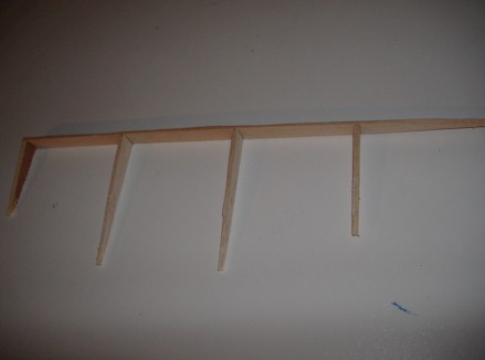

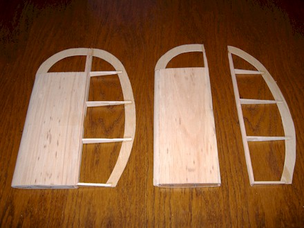

So, let continue with the V tail.
So, I'm on target and made the liteply TE and parts for the V-Tail :

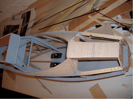

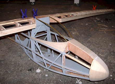

This time, on the fuselage and the cockpit section.
First it's time to glue the bottom canopy frame :

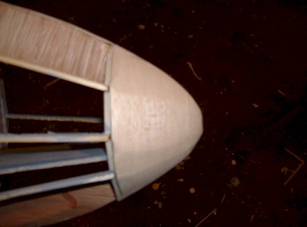

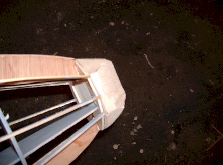

Then, cut a balsa block to fit the nose. The only "difficult" part of the job here is to respect the sides of the fuselage on the balsa block during the sanding.
Before :
After :
  • Posts: 5238

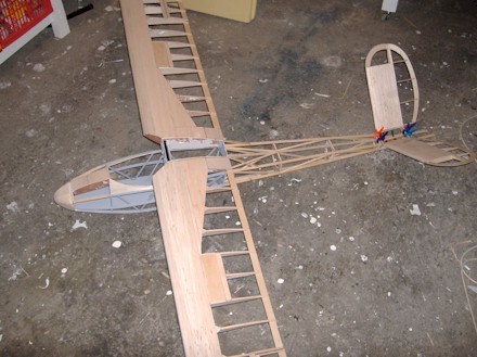

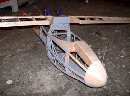

Then, as usual, put the wings on the fuselage... Can be proud of the result now !  ;)
And just for the pleasure, I've cutted 2 tubes for the canopy frame to have an idea of the finished product.
Happy !
So tonight, the plan is to finish the canopy frame, and this week end, the wings.

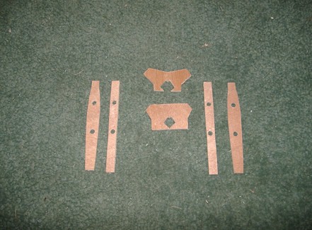

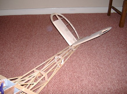

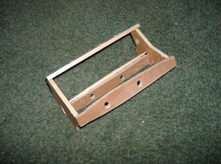

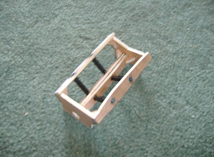

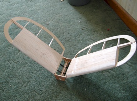

This week end were the days to design the V tail mounting system.  The trick here, is that I wanted to have the V tail removable in 2 pieces. The V tail is huge and if you really want to gain space, you need to have a 2 pieces tail.

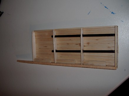

So, finally, after 3 prototypes and a bit of brain cells, I've found a very simple solution to my problem.
4 pieces of wood, and 2 carbon tubes and that's it !
Then, plug both elevator/rudder :
Fit perfectly !
Happy !  :)

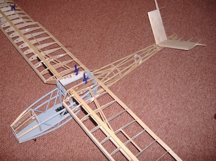

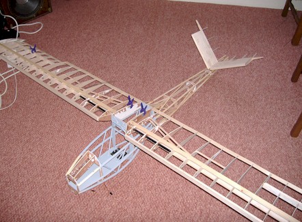

Then, it was time for a last look at the wooden structure before the covering start :
Hopefuuly, finished to cover during the week, and maiden is plan this week end, weather permitting !
