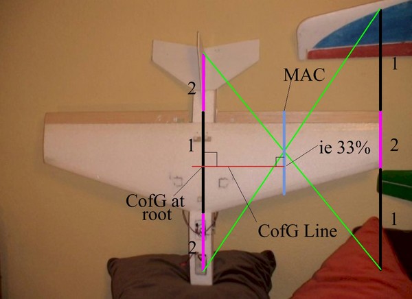

Using your photo ,which has your near wing half pretty much in plan view, I calculate the CG at 140mm-145mm.
Brian

CG has an element of personal preference.
I always end up at 32% of Mean Average Cord (MAC).
For slope slightly forward helps penetration, so go for 30% MAC.
That figure I gave is a guestemate from photo.
That wing is tapered so MAC is half way out a wing panel.
Measure 30% from LE at half span each wing panel and join the two points through the centre to get the point at the root.
Brian

Might help everyone, but here is how to find the Center of Gravity using the geometric method...
You can find loads of excel spreadsheets on the internet to find your CG aswell !  :D
First job, is to find the MAC, then you position the CG at whatever % you want (I usually go between 25 to 33% depending of the profile, machine type and so on...) on the MAC.
Draw a line from that point to the root (perpendicular to the root), and that is your CG line.
Basically, you can do the CG of your plane anywhere on this line.
PSS-JET T1000

To try and figure how the T1000 designer comes up with the 110mm value, as from the calculations i made and i was using 33% i didn't get that value.
Fred, thanks for the excellent graphical explanation.
When it comes to online CG calculators i usually use this one:
 http://www.blueskyrc.com/cg/index.php
But there are many more.
For the next fly I'm going to keep along those lines using 30% to 33% and see how it fly.
