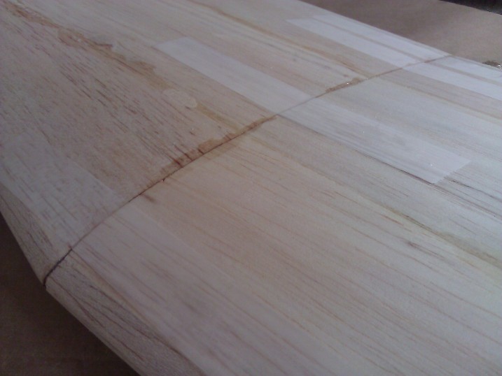

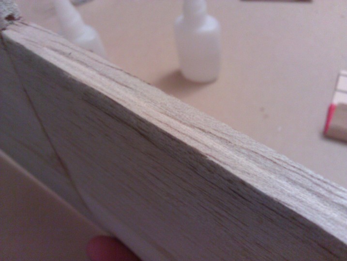

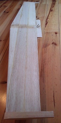

Next was gluing the two wings together. I've read every possible opinion about Ninja dihedral but I went for the suggested 1 inch elevation at the wingtip. SIG claims the foam cores are already cut at the approximate angle for that, and I found that to be quite accurate. A tiny bit of sanding and I had a nice joint, went together with 30-min epoxy and taped in place.

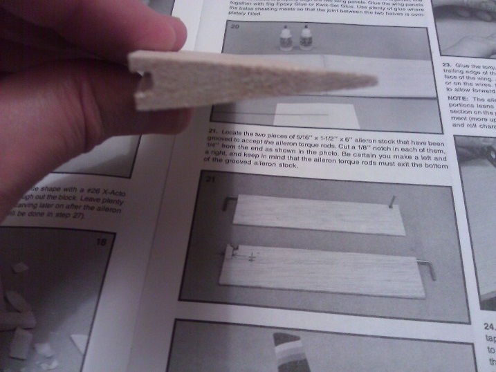

And then the fixed portion of the trailing edge that houses the aileron rods. This is done by driving a bent rod through a brass tube that is concealed inside a grooved section of the trailing edge. Better seen than explained:
So what I found was that even pushing the brass tube all the way inside the trailing edge piece, the tube protuded just a tiny bit. I ended up sanding a very shallow groove in the wing, it seemed easier than deepening the existing one on that tiny piece! Here are the two wings glued together, with the right side of the trailing edge already in place, and the left side with a tiny groove being sanded. Once that was done, the piece would sit tightly and aligned just as required.

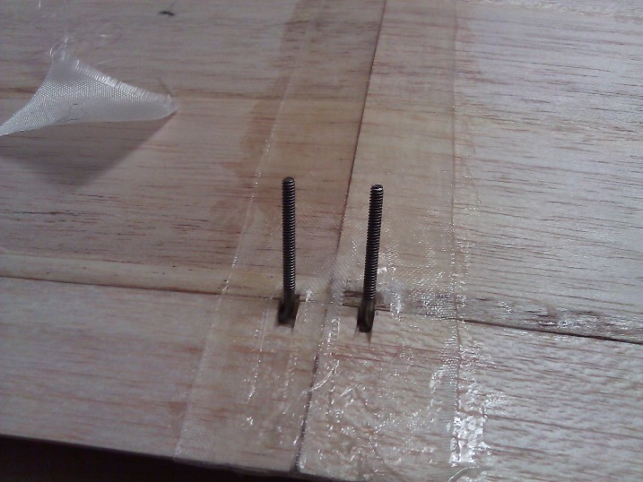

Another new task for me, glass reinforcement. I applied a generous amount of epoxy, then placed the cloth on top and squeegeed with a bit of plastic-coated cardboard. Nice finish except at the edges where I had to cut the material, then threads would come loose and become quite unmanageable once soaked up in epoxy.
Now I'm dreading the task of reinforcing the outside of the fuse as I had planned - the glass cloth I have for that is quite coarse compared to this one provided by SIG, so more chances for fibre threads to go wild. Any suggestions to keep glass cloth edges under control?
Starting to look like a wing...

Regarding the fiberglass finish, plastic bags are your friends. Not sure what the correct name is but it's the "soft" clear bags, not the ultra thin(noisy ones) but the more substansial ones.
Put them over when you've squeezed out most of the epoxy, "rub" them lightly down but beware that any crevises and folds will show up on the finished coat. This will give you an almost mirror smooth surface and help keep the edges neat.

OK, I think I know the type of plastic you are talking about (increasingly harder to get here since the introduction of the shopping bag levy), but I have a stupid question for you: do you keep the bag while the epoxy cures, or remove it immediately after rubbing it smooth, half-way through the curing process, or...? As you see I have no clue if epoxy sticks to that kind of plastic. Ah, blissful ignorance.  :?
Thanks for the tip! I'll try that with the fuse. Too late for the wing but fortunately the ugliest bits will be hidden from view.

« Reply #37 on: December 23, 2012, 15:18:47 PM »
I let it cure with the plastic on, that gives the smooth finish.
You might want to do a test to see if the plastic you have sticks to the epoxy, food wrapping film doesn't stick but it is so thin that you'd probably have a hard time getting it go on without wrinkles.
I cut down sandwich bags.

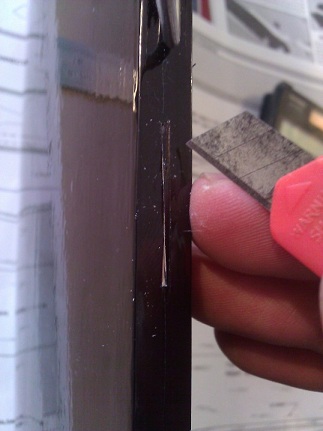

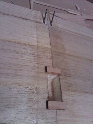

Meanwhile, wing work continues... cutting out the servo space. I was concerned about hitting the bottom sheeting with the blade and damaging it but I found a way of combining blade and a flat screwdrive for scooping out the foam that left a reasonably straight servo housing. All lined with a generous layer of epoxy.

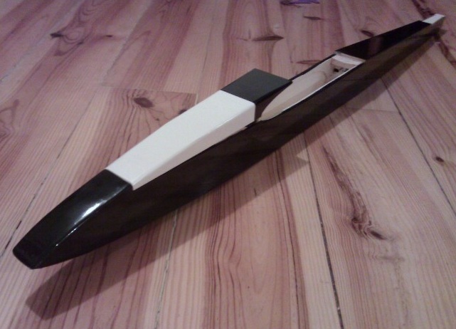

OK, so next was covering. Again, something I've never done before, so I started with a scrap piece, then the elevator, then moved on to the canopy, and finally did the entire fuse. I have no idea about what "finished" is - I used just enough heat to activate the glue and get things in place, and then increased temperature to get the material to shrink and get the right shape. But how far is good enough? I don't want to warp the model, so no extra heat applied where things looked OK. Reasonable approach?  :?:

Yea, slot cutting is such fun! 8)  I love it. :D  (Not :( ) But look at it this way, wouldn’t life be boring if everything was easy? :wink:
Nice bit of covering by the way. You’re doing it the same way I do,….and as far as I know, just about everybody else does it as well.
Just one slight potential hick-up to warn you of. Black covering is a devil in hot sunshine. You might find it ‘bubbles’ or becomes loose if left in the summer sun, especially if left in the sun while inside your car. If we ever get another summer, best thing is to keep it in the shade until you come to fly it. (Just something to be aware of.)
