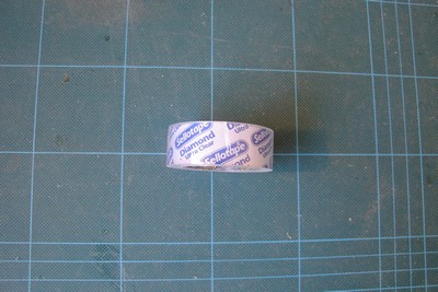

As for hinging the aileron. There are dozens of different ways. Personally I use the quickest, which I’ve found to be 'Diamond' sellotape! (Less time in the workshop = more time on the slope! )
Hope this helps. (You might like to try covering a small piece of scrap wood before covering the actual wing. Like I said, there is a skill to covering a model without leaving any creases or unsightly joins.)

Only place I know that has diamond tape at the moment is T9 Hobbysport in England. It is my understanding it is no longer in the Sellotape range!!
