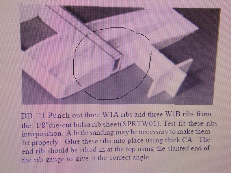

I think John is right David. Wing joiners don't usually come directly into contact with ribs. I think there should be a  'flat sided slot', or 'socket' for the joiner to slide into.
Here's a picture from the plans of one of my old models. (this is from a Spirit Elite) it shows the “socket” that links the first few ribs of a wing half (so spreading the load) and allows the joiner to side into.
Go back to your plans and see if there isn't something similar shown.
(You're not the first person to hit problems with you first build. We've all been to the place where you try fitting the model together and suddenly felt a rather hollow feeling in the pit of our stomachs  :oops:  )
