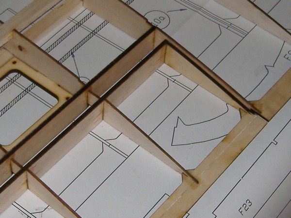

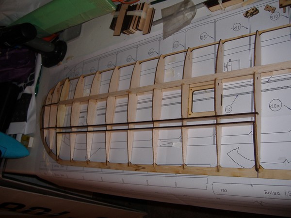

I also did som bits and pieces on the wings.
I closed both ends of the ailerons.

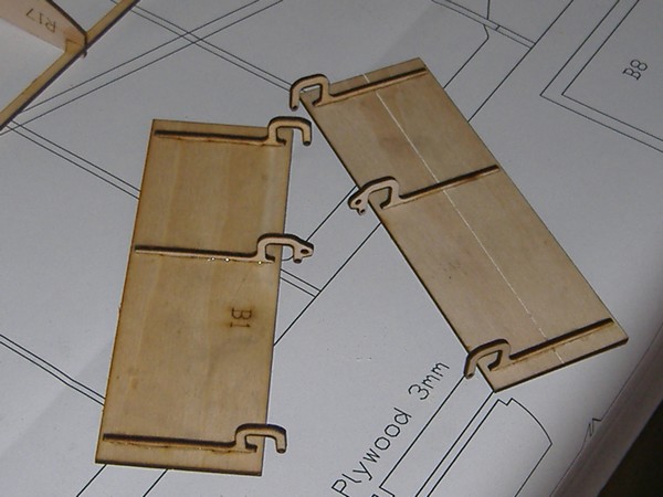

And started to have a look at the airbrakes system. Achim did a really good job here!
All the pieces are in 2mm plywood.

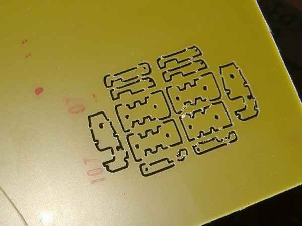

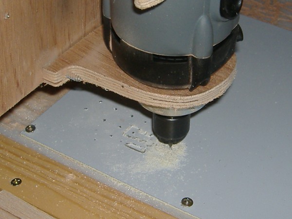

But I have CNCed the supports on the wings for the hinging in epoxy
But I went a bit too fast for the cutting. Haven't payed attention, and cutted the epoxy at 20mm/s with a 0.8mm bit...! Should more be 10mm/s to have them perfect, my mistake !
I'll redo them when I have 5 minutes.

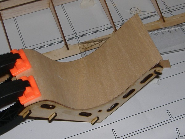

And I did the sheeting for the seat in 0.8mm plywood...
And that's all for now !

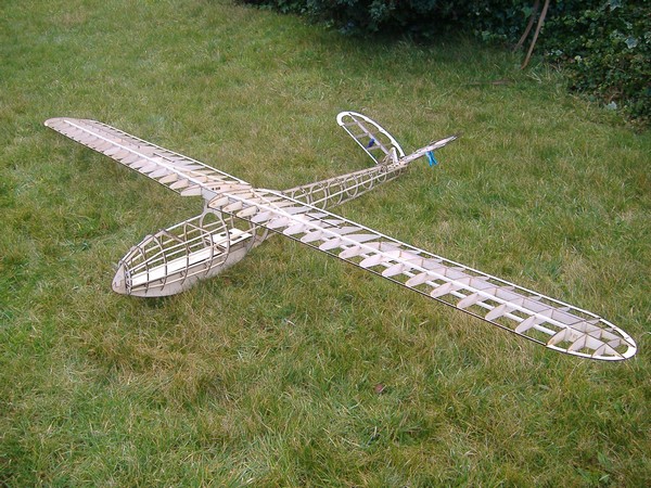

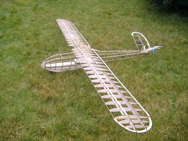

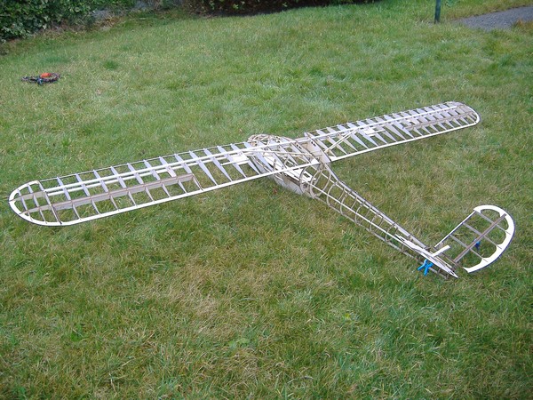

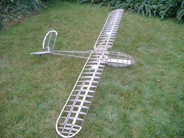

Well, that's it ! The main building is done (structure).
Now all the sheeting + Servos installation need to be done.
Here is a picture of the Ka1 with 99% of what is going to be the short kit parts fitted (just add your joiner and balsa strips to get to this stage). Missing from the photos are the airbrakes and a few bits and pieces (ailerons top/bottom, cockpit enclosure...)
I'll start the fuselage sheeting next week. Long job ahead !
