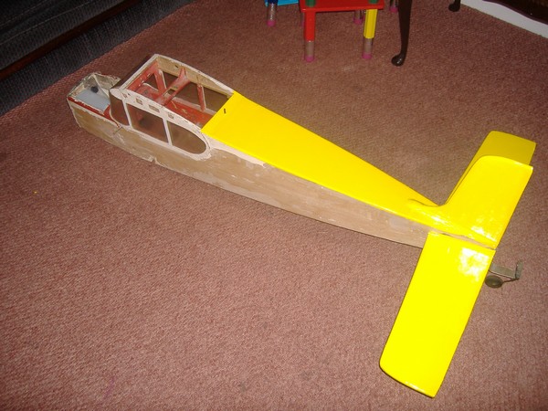

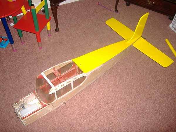

Tow plane is back on track !
Yesterday evening, started the re-covering of the beast.
Will be all bright yellow for better visibility  :D
Slowly but surely, I hope to have it ready for Retroplane along with the electric one.

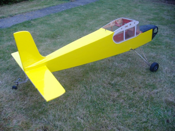

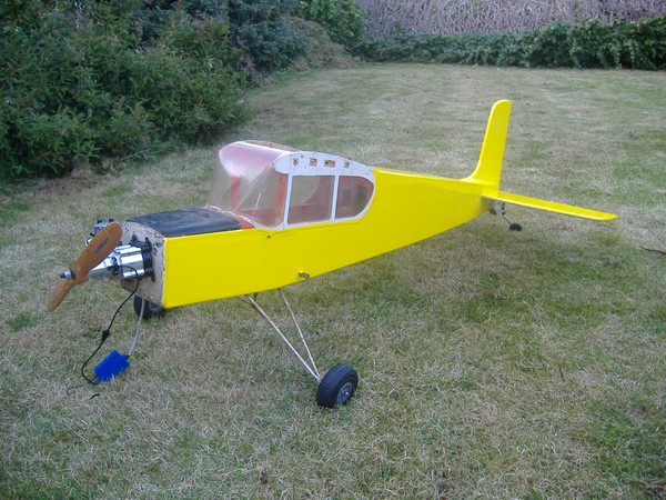

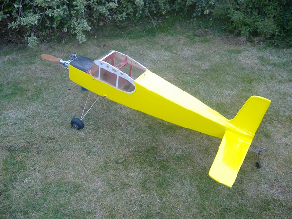

« Reply #8 on: April 21, 2009, 11:02:03 AM »
So, here is the progress so far  :D
A little bit of work every now and then...
Going to be visible I'm sure...  :lol:
BigLift I - Rebuild
« Reply #9 on: April 21, 2009, 17:56:32 PM »
Corrrr, you've certainly got a big one Fred! :shock:  :oops:
  • Posts: 1058
BigLift I - Rebuild
« Reply #10 on: April 21, 2009, 18:56:08 PM »
Hey Fred. Is that the old MPX Big Lift.
  • Posts: 5228
BigLift I - Rebuild
« Reply #11 on: April 22, 2009, 07:22:05 AM »
Hey there  :D
Wel Keith, not that big, but all square, that make it bigger than that thing really is I think !
On the nose, a 26cc (originaly, this plane towed hundreds of gliders with a 15cc...), but if we have lots of interrest, I will go for a 45 / 50cc in the future... (The 26cc with the 18x6 pull 5kg static...)
Alan, this is an original vintage BigLift from Multiplex... About my age !  Pure unobtainium !  :D
Full functions, at the time, we used to put a video camera on it (there is a window on the belly), tow hook, top (gliders) and bottom (parachutes, banner) etc etc... All the linkage were push/pull with steel cables, but now updated to a more modern standard !  :)
