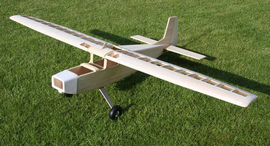

« Reply #20 on: May 16, 2009, 17:29:59 PM »
Hi Fred
here it is my baby, first assembly today, I think it will fly end of May.
Cheers
Stephan

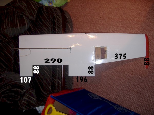

« Reply #21 on: May 16, 2009, 21:48:27 PM »
Looking good Stephan !  :clap:
Here are all the dimensions for you for the ailerons and flaps :
I hope to have mine done sometimes in June now  :oops:
