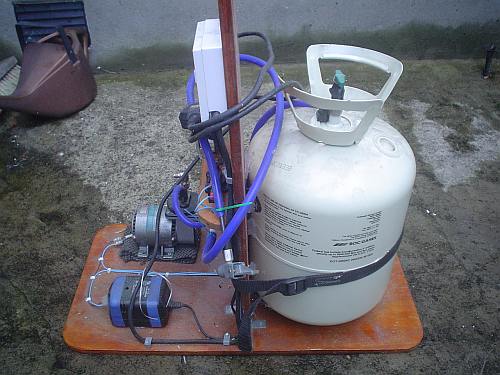

« Reply #7 on: September 17, 2009, 19:12:07 PM »

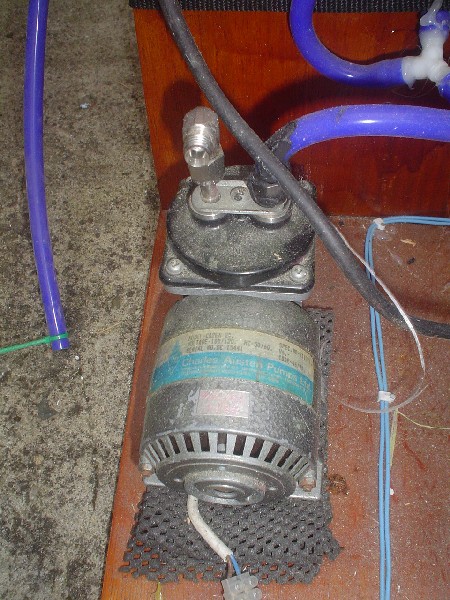

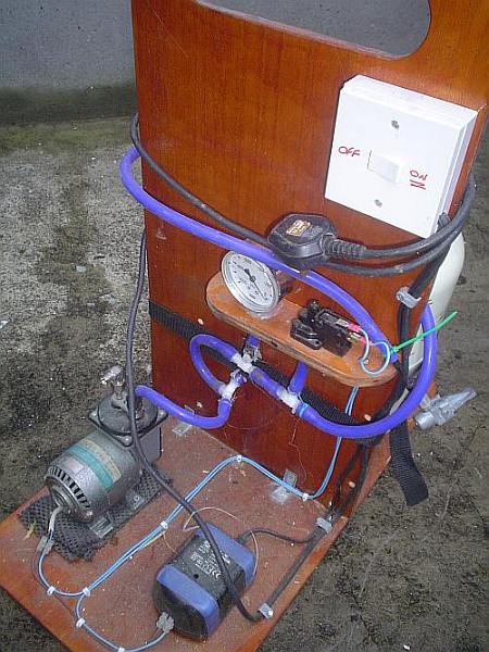

Joe was asking about Vacuum bagging last weekend, it's the next logical step after cnc cutting.
Below are a couple of pics of my set up. Done for <£100 by watching Ebay for the pump and getting the rest cheap too!
For anyone looking for good simple info have a look at Joe Woodwoker http://www.joewoodworker.com/  and their shop http://www.veneersupplies.com/
In the UK there is also www.tygavac.co.uk , although I've never bought from them.
Overview, the reservoir tank is a disposable helium tank from a balloon shop
My pump was bought from Ebay for ~£25

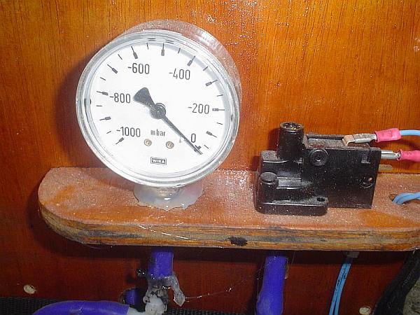

Gauge for vacuum and a vacuum switch from Joewoodworker. This switches the pump on and off rather than continuous running.
The wiring, tubes, transformer etc.

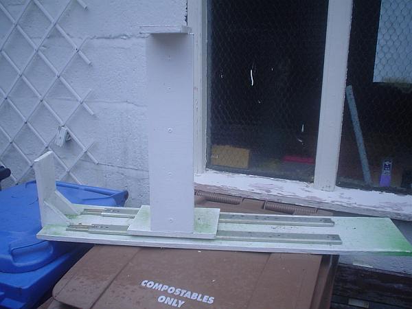

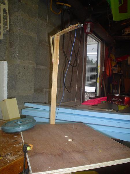

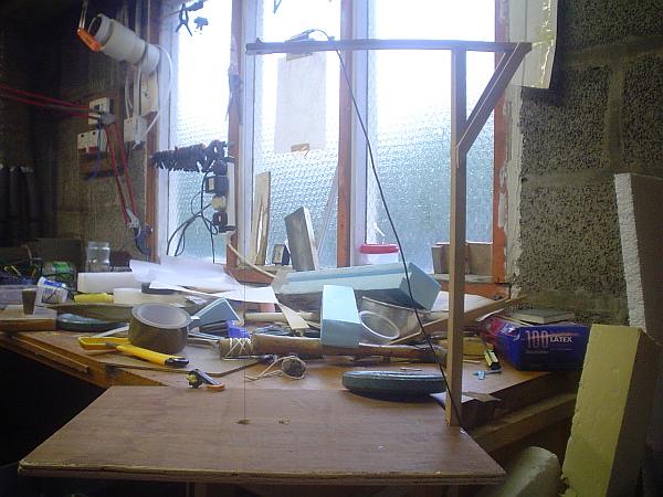

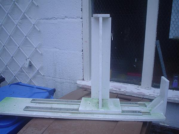

« Reply #8 on: September 28, 2009, 17:51:11 PM »
Knocked this up tonight for a little project. It's basically a vertical hot wire to use for rough shaping foam for lost foam fuselages.
Easy enough for Joe with his fancy machine, but this is the way us plebs do it!

So talk me through you vac set-up Bill.
I get the meter and the switch so the pump is not running continuously. I guess you have a check valve in there somewhere too. Tell bout the job of the tank if you would?

« Reply #12 on: October 01, 2009, 15:46:20 PM »
Quote from: "joe"
I have a one way valve just before the bag and one just after the pump (Aquarium shops).
My reservoir tank is one of the reuseable helium tanks you can get from Party Balloon shops. Anything which will hold the pressure is fine. Old calor gas cyclinder, fire extinguisher. I've also seen them made from Plastic pipe with end caps and then drilled and tapped for fittings
http://www.joewoodworker.com/docs/ProjectEVS.pdf
This is a downloadable plan for a vacuum pump and explains most things
http://www.veneersupplies.com/vacuum_press.php
Page of info incl. video on building a pump
