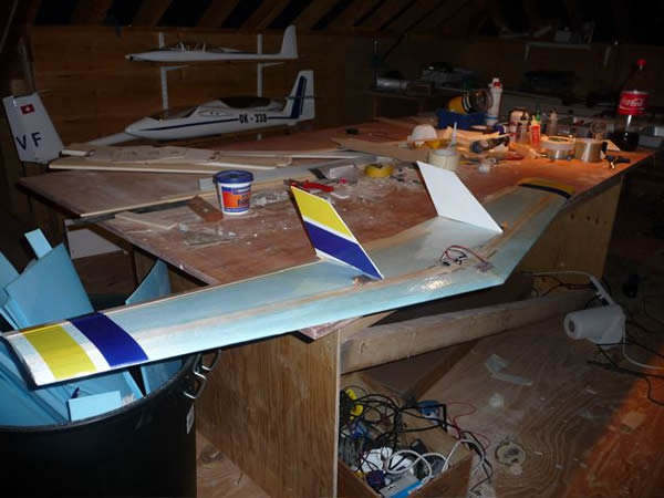

So having gotten a bit bogged down and lost a bit of interest in my other projects for the moment. I decided to distract myself with something completely different.
The idea is to design and build a simple basic flying wing purely for racing/DS. Just for fun and a bit of design/building experience and also with the idea that if we get round to doing some foamie racing that a cheap wing that I can cut might be a good thing so people can give it a try for very little cost. Maybe racing with one design could be a goer too as then it is just down to the pilot.
So this is to be just a tester, the first of many I would imagine! I set myself a couple of rules. Main rule is not to get bogged down it this. Just do it. Finish in two or three days max. I must use the first wings that are cut and not faff around with cutting cores. It must be cheap. So I am using blue foam and a pine spar from the local DIY (EPP version once I get a design that works). Use stock trailing edges. TE stock i have is not really the best but, see main rule.
Design 1.

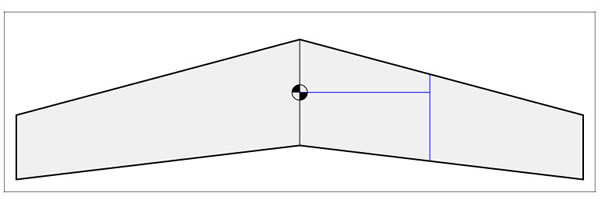

Very simple swept wing. Central or twin fins. Profile PW51. 1500mm WS (59")
Basic planform.
Cut wings and glued together last night. One wing profile is a bit messed up towards the wing tip but, I stayed true to my rule and used it anyway(hope I don't regret it). Have made good progress so far today. Will post some photos later.

Can’t help thinking that those fins look a bit small Joe.
I believe the nearer the fins are to the wing’s M.A.C. the larger they should be. The fins on your model look about the size of  those on a Zagi who’s are much further back from the Zagi’s M.A.C.
Could be an optical illusion, or that I’m wrong. (Both of which are entirely possible! :oops: )
Guess the answer is to fly it and see. If you get a problem with yaw stability………make ‘em bigger

They do look a bit smaller in the photo than reality. But you may well be right, they might be too small. The tips are probably the best place for them. For some reason though I've never liked the look of wings with the fins on the tips. I will try the center fin set-up as well as I like the look of that. The twin fin was the easiest to start with. The fins are not a big worry at the moment as they are easy to enlarge/move.
Will finish tomorrow and try to make a center fin to test as well.
All up weight will be around 700grams giving a wing loading of:
21 g/sq.dm(6.78 oz/sq.ft)
Thats fairly light which is a good start. If I can get it stable I will add ballast, which according to Peter Wick the PW51 loves!
Here's some numbers if anyone is interested:
http://fwcg.3dzone.dk/?wing_span=1500&root_chord=280&tip_chord=170&sweep_type=0&sweep=200&cg_pos=20&show_mac_lines=0

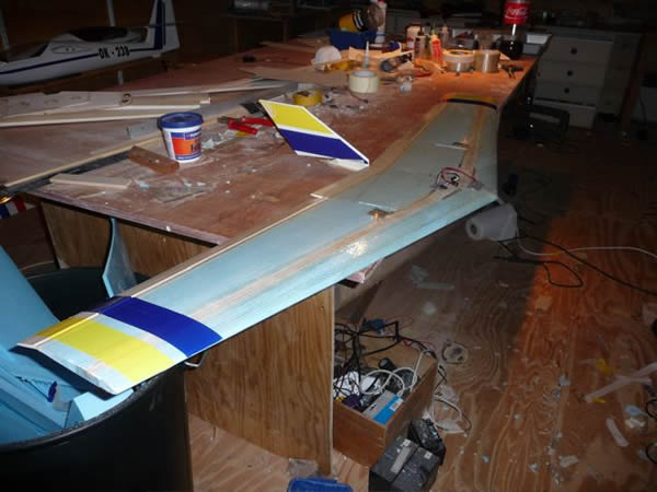

Got a bit more done tonight. Basic fibre tape covering. Didn't worry about trying to make it really ridged. This is just a test model and if I fold the wings then it probably means it's flying OK so I won't mind too much!
To get an idea of how it would look with one center fin.
