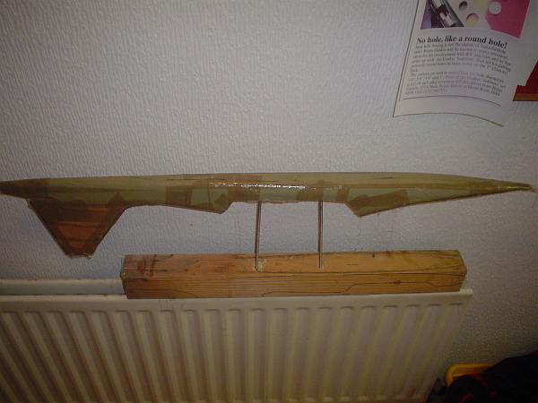

Then I got on with glassing the lost foam fuselage. Attached is a pic of the fuz with the first layer of light glass added. Tomorrow I will put on some carbon reinforcement, (around the wing mount and LE of the fin).

Hi Bill. Good to see the jart back on the building board. What weight and how many layers are you going for?

Not aiming for any particular weight Joe. More concerned with durability.
That first layer is a light cloth (50g/m), easier to work with on the smooth tape surface. I'm then planning on a length of 50mm carbon tape along the bottom from nose to tail and layer of the same tape on the LE of the fin. Possibly a criss cross pattern of Carbon tow nose to tail to give an overall strength. Then at least 2 layers (maybe 3) of a heavier cloth (100g/m), finishing off with another layer of the 50g/m.
That's the current plan, but I will adjust if the strength doesn't seem too good. Hope to get the carbon and one layer of 100g/m done tomorrow and then cut tails for it.

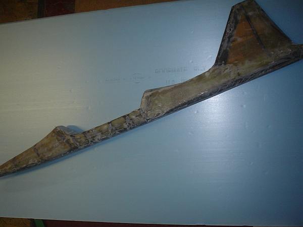

As I said in my Fiu thread, a productive weekend. Spent today sanding the final layer of "heavy" cloth in the Jart fuz. Resorting to the angle grinder on a couple of stubborn spots to remove epoxy runs. Carbon tape aling the bottom and fin LE. Carbon tow reinforcement in a couple of strategic places. One layer of "light" cloth now needed to finish it off before a final sanding and shooting primer/filler on it.
