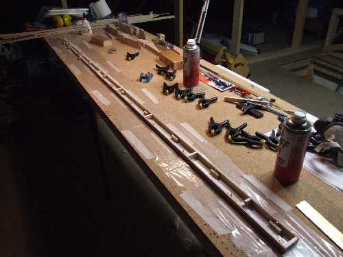

The going has been slow lately. But I have some more work done. I now have the wing and fin spars complete. I can finaly start adding the ribs to the spars. Hopefully in the next week or two things will start to look like a K8. Here are some pictures of the construction of the wing spars.
Under construction
Test fitting
Adding the spar webbing
The finished spars and fin spar

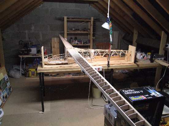

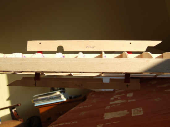

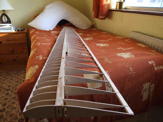

Here are some more pics. The wings are starting to take shape now.
Here the leading edge ribs have been glued to the spar. Have attached the wings to the fuselage to see what they look like.
Here I am glueing the trailing edge ribs in position. Before I finish the trailing edge ribs I have to make and attach the airbrakes which is what I am working on now.

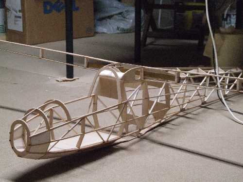

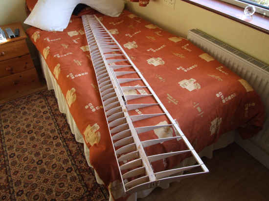

OK. Here are those picture. As I said the wing is a bit rough. It needs to be cleaned up and sheeted. But the airbrakes appear to work. Working on the second one now.
DGC Ka8b
« Reply #57 on: April 17, 2008, 07:24:53 AM »
Looking good Alan !  :clap:  :clap:
The servos for the airbrakes are on fuselage ?  :?:
DGC Ka8b
« Reply #58 on: April 17, 2008, 11:16:00 AM »
No. The servos for the airbreaks will be in the root of the wing (two ribs in, between the second and third rib). The aileron servos will be out were the ailerons are if they fit, i hope.
