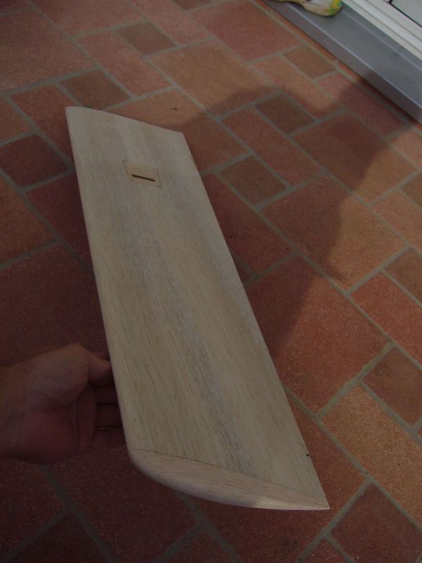

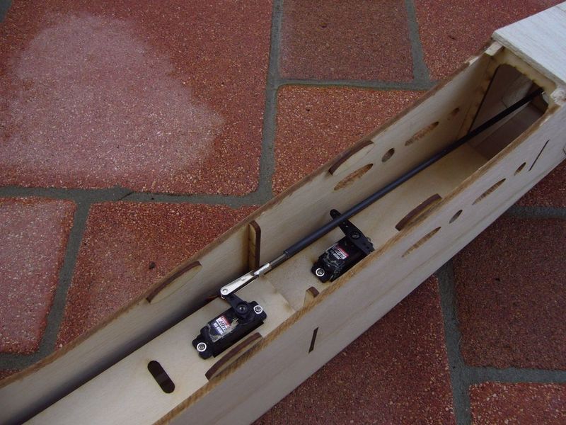

« Reply #230 on: May 30, 2012, 15:09:44 PM »
Hi,
here are the first pictures of my build - all goes together really well. Fuse is not rounded yet. The elevator turned out really good, 44gr both halves together. I built the rudder with 3mm parts sheeted with 1mm, it is really stiff now but still very light.
The most annoying part of the build was sanding down the 3mm carbon rods to fit into the tubes - the inner diameter was 2,8 instead of 3mm :!:
Waiting for the 8mm carbon tubes now to start the wings...

Beautiful work  :clap:
It is very satisfying to see good workmanship.
« Reply #232 on: June 01, 2012, 10:06:47 AM »
Hey Miki,
Well, you are not wasting your time! This thing is half built already!  :clap:
Quick question for the elevator, did you build them with ribs etc as per the latest plan?
44grs for the 2 halves is very good  :clap:  Looks like you will have the lightest Quark made so far  :D

« Reply #233 on: June 01, 2012, 13:13:14 PM »
Yes, the elevator is with ribs and 1mm sheeting - really easy to build.
I've got one wing almost done (needs only some sanding at the LE and wingtip), when i put it on the scale I couldnt believe it: 225g with one servo and fully sheeted! Really very light, the fuse with the stabs comes in at ~430g. I didnt really try to build light, but it comes together very well. AUW around 1,2kg should be possible (I will see how much lead will be necessary...)
