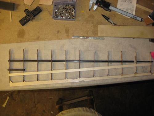

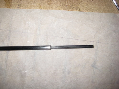

:clap:  :clap:  :clap:  carbon tube arrived today  :clap:  :clap:

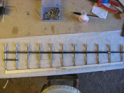

this is the 8mm carbon tube reduced down to 6mm for the last two wing ribs
trailing edge, ribs and spare all assembled
Quark 1.2m
« Reply #19 on: October 18, 2011, 21:24:35 PM »

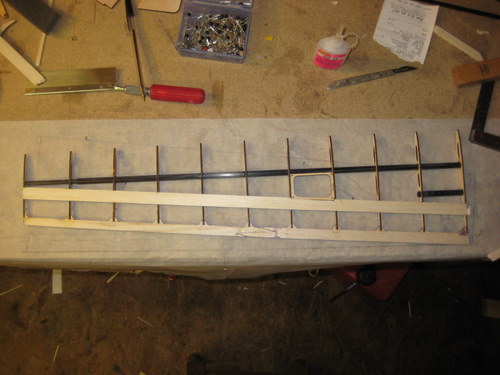

balsa strip added on top  2mm x 10mm
and 2mm x 16mm balsa on the bottom
take my hat off to Fred the tabs on the top of the wing ribs are a brilliant job for keeping the wing straight while upside down  :clap:  :clap:  :clap:

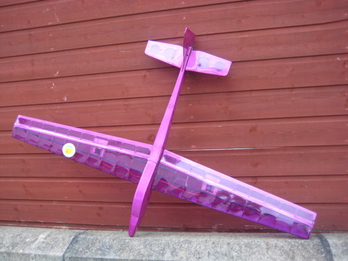

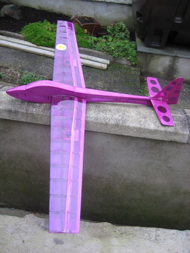

sorry guys i'm a bit late with the update and photo's
all ready to go all up weight is 428g and it took 70g of lead to get the cg set
now i'm using the main spar for the cg but the weight could change after a few flights

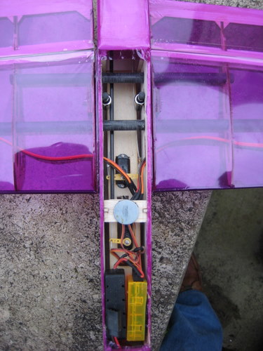

i'm using 4 turnigy tgy-1440a mirco servo's, a 350mah flightpower 7.4 lipo battery with a 6v regulator and an orange rx

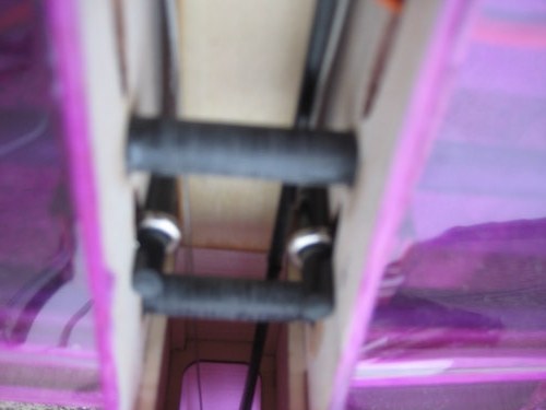

the last picture is how i keep the wings on i'm using cup hooks and a couple of pieces of carbon

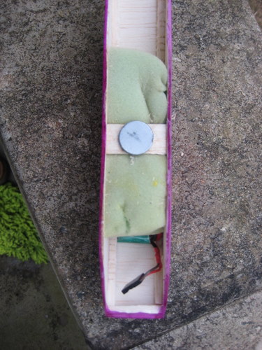

and this is where the battery goes in the canopy
