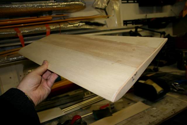

Here is one of test tailplanes completed, foam with balsa skin, just need to cut a section off for the rudder movement, hopefully I will get the other completed tomorrow, just needs balsa skin applied.
Biggest tailplanes I ever made, 1/2 m each  :?:
johnp
Kostez
« Reply #24 on: November 19, 2011, 13:25:52 PM »
Nice job John  :clap:

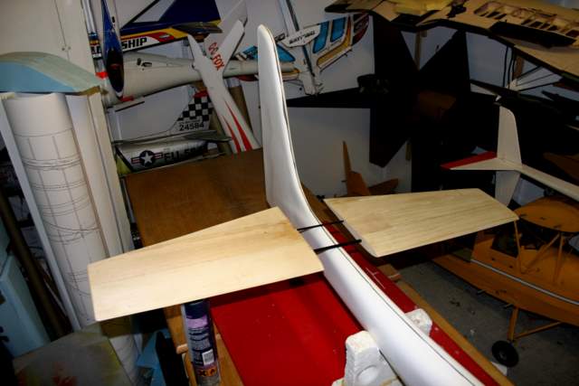

Finished the other tailplane today, so ready to start wing cutting on the second set of tailplanes and then, the main wings.
The profiles for the wings are ready thanks to Bill, just need to cut them out and start cutting with the hot wire.
Tailplanes ready with carbon tubes installed ( wings the size of some of my small gliders!!)
Kostez
« Reply #26 on: November 20, 2011, 09:10:19 AM »
hey john you're on fire with this building  :D
things are looking good  :clap:  :clap:  :clap:
can't wait to see this in the air  :shock:
Kostez
« Reply #27 on: November 21, 2011, 08:52:50 AM »
Looking good John!  :clap:
Your B52 Elevator is smaller?  :?:
