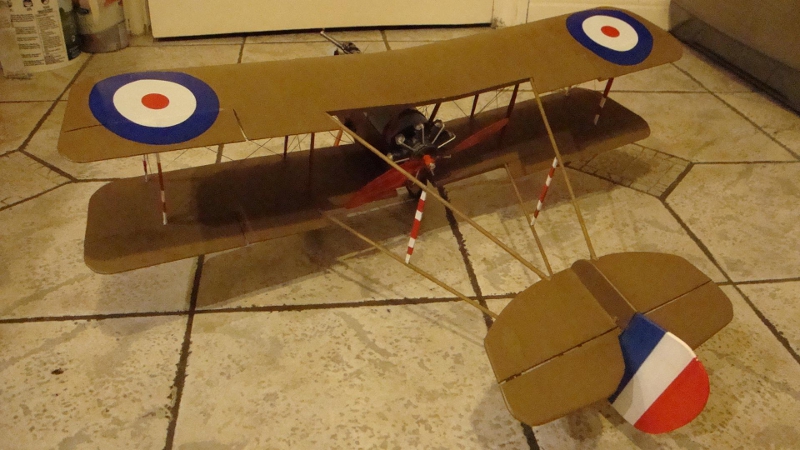

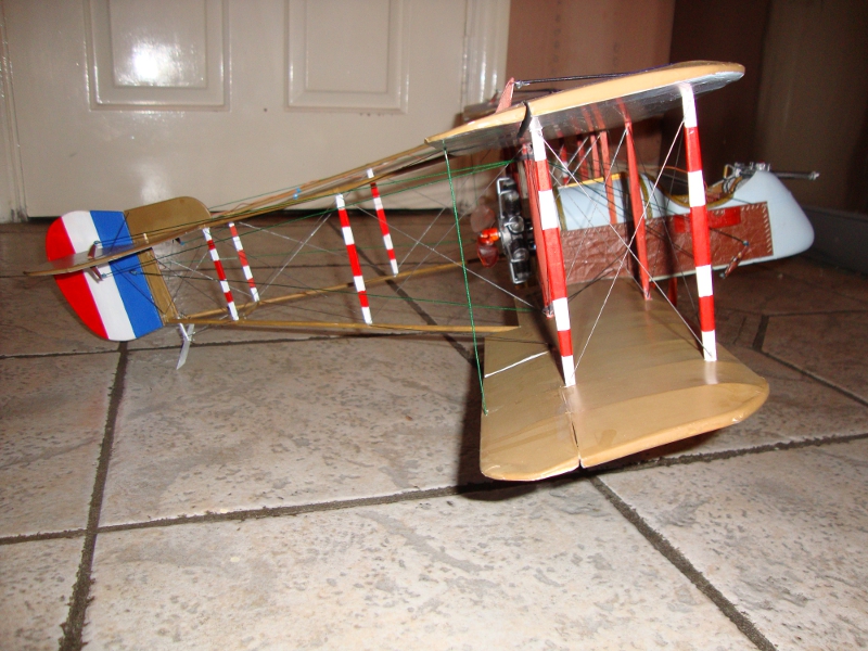

Hi All,
       Love this model, I have cut and chopped this kit to make it more scale and am really enjoying the build. Sorting out the wire rigging(there's an awful lot). Control surface cables are ready for connection as per full size ie on the outside. The aileron control was a wire led along the leading edge of lower wing to a pully to turn 90 degrees to lower aileron horn then both ailerons connected at trailing edges by cable  and connection from top aileron horn to leading edge of top wing by spring on top wing aileron. Should work ok I'm using fishing trace coated wire for the control wires and painted fishing line for the rigging. I dont like the nose on this kit as I think it's way off scale and may modify it to suit. The model is getting a bit heavy but I have tried some runs in my living room under power and I think she's gonna fly albeit just like the real thing (barely). Just what I'm looking for.

Meautiful job. I wish my building was half as good :(

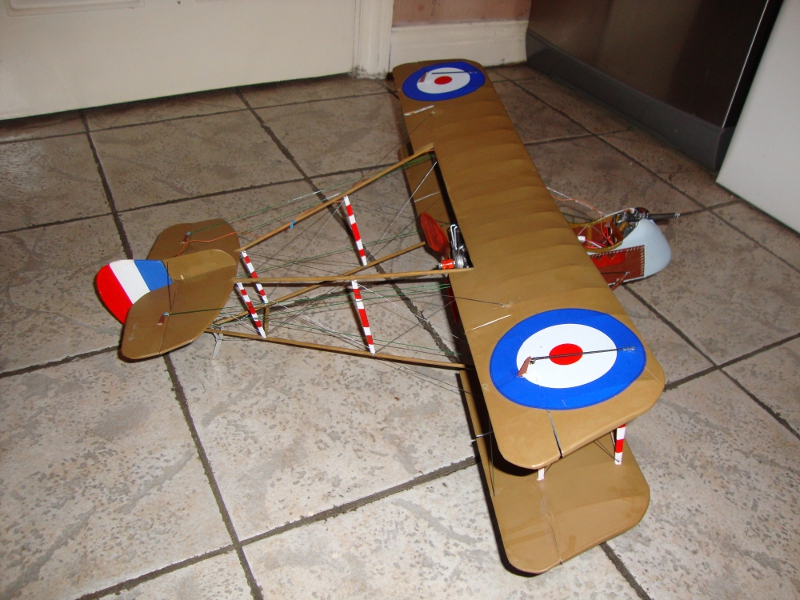

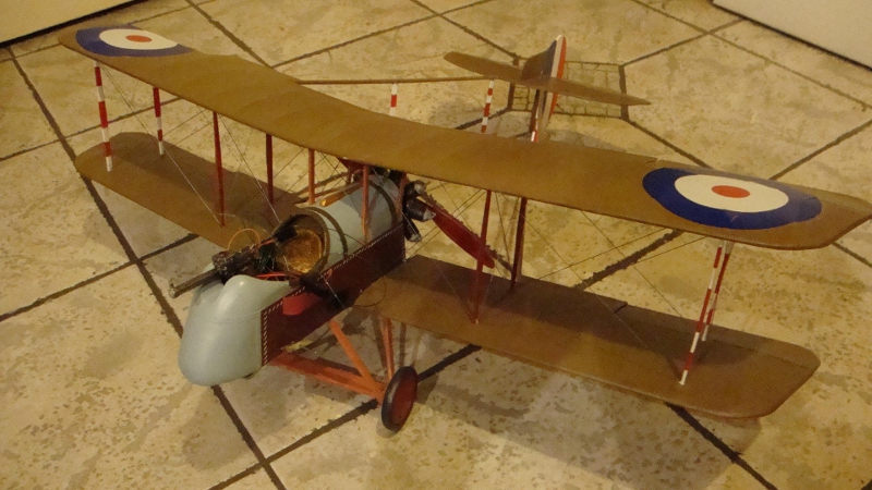

      I had some fun with my DH2 today. It's not finished yet but is flyable so I decided to give it a test run to check out the power output and just as well I did. It needs about twice as much thrust as I'm getting so I'm guessing I need an outrunner powered with a 3 cell lipo. The weight of the model without battery is 240 grms.
http://www.hobbyking.com/hobbyking/store/__5428__AX_2306N_2000kv_brushless_Micro_Motor.html
http://www.hobbyking.com/hobbyking/store/__5430__AX_2308N_1800kv_Brushless_Micro_Motor.html
http://www.hobbyking.com/hobbyking/store/__5427__AX_2306N_1300kv_Brushless_Bell_Motor.html
http://www.hobbyking.com/hobbyking/store/__6784__ZIPPY_Flightmax_800mAh_3S1P_20C.html
http://www.hobbyking.com/hobbyking/store/__6457__Hobbyking_SS_Series_18_20A_ESC.html
These are my choices as they have the beam mounts and will fit with little mods required. OK what do I choose? I want to run an 8" prop for scale reasons and I don't really want a revving noisy fecking thing. The model at present has a 10 amp esc fitted in it's bowels and if possible I would like to leave it there, but if necessary will replace. Prop suggestions? Perhaps running with 2 cell lipos and less rpm. I'm new to this electric and perhaps need a little guidance. I broke the undercarriage today and I am  now redesigning for strength which is difficult due to its gangly nature.

I'm not up on electrics John, but I would suggest due to the draggy nature of the airframe it's going to need something with plenty of torque, but that you don't want something which will make it hurtle round the sky in an unscale manner.
Have you had a look at the calculator, (now FREE) on RCAdvisor?

You say that the esc is bedded into the bowls of the model, you need to be aware that it requires a cooling airflow to stop it overheating.
Another thing I’ve thought about relates to that dummy engine. Is it balanced? and is it strong enough to withstand being rotated at around 10000rpm? which is the sort of speed you’re heading towards with an out runner.
Of the outrunners you are thinking of getting, probably the 1300Kv model would be most suited. I see it draws 8 amps current, so to be safe I’d be thinking of using an esc able to handle around 15 amps. (Personaly I'd stick to a two cell battery.)
Here are some facts about props:
As for prop sizes; changing the diameter of the prop will vary the rate of acceleration and rate of climb i.e. changing the the diameter doesn’t change the top speed of the model.
Changing the pitch of the prop varies the overall speed of the model but also varies it’s rate of climb and rate of acceleration. Confused yet? :!:
Look,…….If you have (say) an 8” diameter prop with a 4” pitch. The thrust it produces at (a given rpm) will cause the plane to climb at a certain rate, and have a certain top speed.
If you maintain the 8” diameter and reduce the pitch size, the plane will climb faster but it’s overall top speed will be slower. (Like using a lower gear in a car.)
If you want to maintain the same top speed and increase the rate of climb you would have to increase the diameter.
All of these variations however will effect the amount of current being drawn by the motor, esc and battery, because they all form part of what's called the ‘Power Train’
( At a given rpm, doubling the propellers pitch will increase the power requirement by 50%. Maintaining the same pitch but doubling the diameter of the propeller will increase the power requirement by 100%)
As converting this plane to electric flight has never been done before there are no known facts for what would be the best power train for this model, so you are going to have to do a little bit of ‘suck-it-and-see’ John.
To ensure you don’t over load the power train you really need a “Watt Meter” to connect between the esc and the motor as you try different props. This will display a host of information about the different voltage on the battery, current being drawn, current used, and power being consumer at different throttle settings and with different props.
Don’t get disheartened John, Smile! This is all part of the fun of experimenting with model flight, 8)  (so I’m told! :roll: )

           Me disheartened! never. I relish a challenge. Yea with the higher rpm I think I will not turn the engine but perhaps try for a little friction freewheeling. I'm going with your motor recommendation which is what I also felt would be best and have ordered 8"x4" and 9"x6" props and also an 18amp esc. I ran the current motor flat out until the battery died and there was very little to no heating of the esc, I realise the new setup will be different due to higher loading so will test. If v/i=r then running on lower voltage(2 cell lipo) means pulling less amps so maybe 10amp esc will suffice. The worst part is waiting for the bits to arrive from Hong Kong but I am now getting stuck into the restoring of my dads old glider, it's an electric powered precedent from the mid ninties. The 1300mah nicad battery weighs more than the glider.

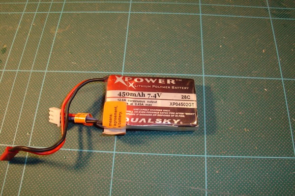

Lets talk about Li-Po’s and look at the following picture.
Here is a little two cell Li-Po of the type you already have.
The markings show that it’s basic current capacity is 450mAh. Just to remind ourselves what that means………it means that the battery could discharge 450milli amps of current over the course of one hour. This is known as it’s 1C rating. (‘C’ standing for capacity)
However the marking “28C” tells us that this same battery is also capable of discharging up to 28 times  it’s 1C rating of 450milli amps, (but for a much shorter period of time of course.)
So, for a short while this little battery could discharge 28 x 450mA.
That equals 12600 milli amps, or 12.6amps. (This figure is also shown on the battery.)
“This is all very well,” I hear you say, “but it’s only referring the battery’s current,  how much power will it produce?”
Well, we know that power (measured in Watts) = VxA
The nominal voltage of this battery is 7.4volts. The max rate of discharge is 12.6amps, so it’s max power output is 7.4 x 12.6 = 93.24 watts

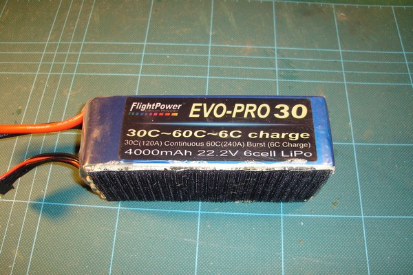

BUT just in case you’re still awake here’s another Li-Po.
It says it can produce 240amps. How is that so when it’s only a 4000mAh battery. And what do you think it’s max power output is? (Answer = 5.328Kw but how do I know that?)
