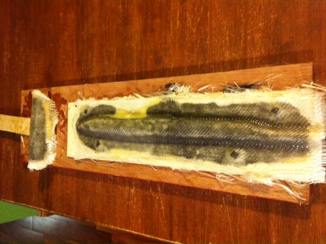

First half of the fuse mould glassed. Now we wait.
Wings sanded and trimmed. 140grams. Not bad for first go.

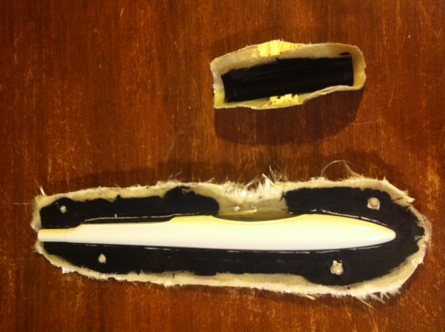

So half of the mould and the canopy is now done. Getting there

Mould's done. Came out fairly good. One side is good and the other needs a little touch up. Can see where i went wrong. Lesson learned(hopefully)
