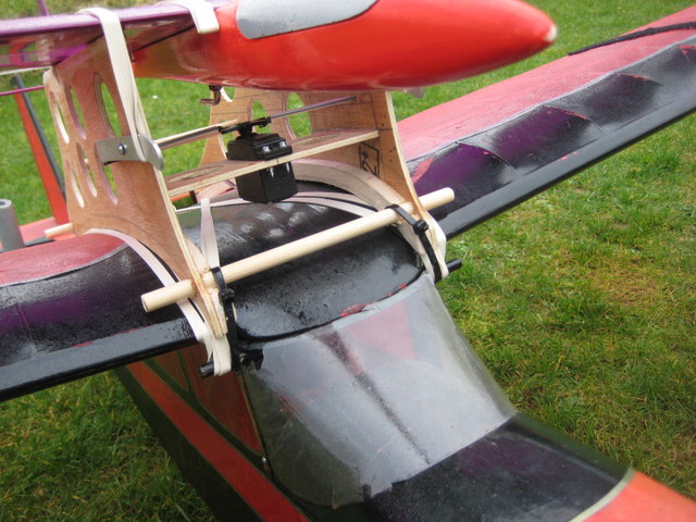

     If you go back and look at the pics of my cradle, notice where the rubber bands are attached at the back of the cradle, up near the corner of the cradle.  When you rubber band the glider to the cradle, the trailing edge of the wing is up against the attachment point and will not allow the glider to slide back at all. In fact it is very tight at the trailing edge and have cut away the monocote and placed 1/32 plywood on a couple of my gliders to keep the balsa from being crushed. I haven't experienced any of my planes sliding back during a launch.   :) As long as you have your cradle mounted firmly on the plane to where it can't move, that shouldn't even be an issue.  I would suggest when you get your cradle done to mount it on the plane and take it up for a flight to see how the Kadet reacts with it on it's back. Have you decided if you are going to add ailerons? I think it would be very beneficial. thanks for the update I'll be in touch, looking forward to more pics. Tracy
Freedom Flyer's sailplane hangar
« Reply #16 on: February 07, 2012, 11:58:45 AM »

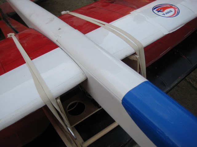

once again tracy you're spot on i moved the postition of the rubber band and that cured the wing slipping back
for the picture i'm holding the cradle on with two rubber bands but i'm lookin at a way to bolt the cradle to the wing :?:

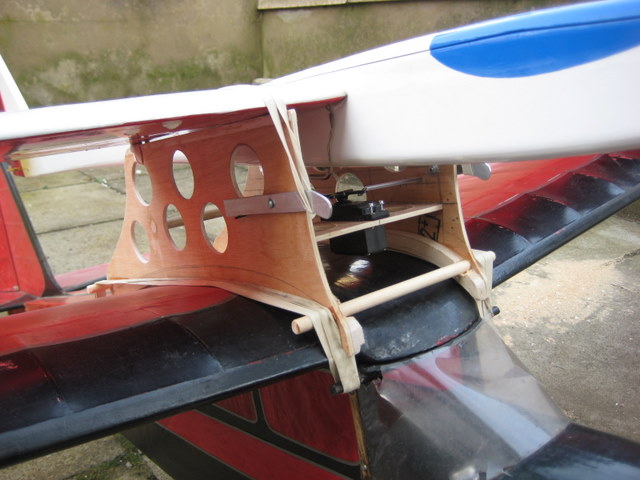

Andrew,

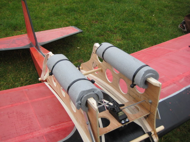

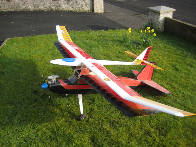

      Great pics, thanks for sharing. I think I like your release mechanism much better, seems like there would be less friction and  a more direct release. I may make that adaptation when I redo mine. :D The Red, White and Yellow sailplane looks to have a pretty decent wingspan, again I would suggest wing supports  about 1/2 way out on the plane wing under the glider wing. There's some really strange forces going on during the flights and I have had  gliders tip to one side or the other during the flight with a cross wind, it makes the flight verrrrrry interesting :shock:  :shock:  :shock:. If your going to haul multiple types of gliders you'll want to make it adjustable to fit the different wing configurations but if your going to haul one type it could be something very simple just to keep it from tipping.  Hope all goes well for the test flight good luck. Tracy

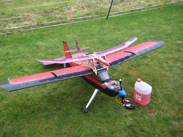

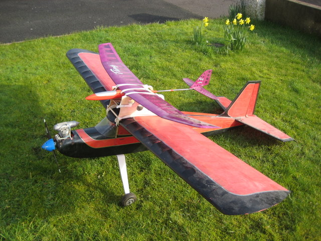

hi tracy finally got out to try the cradle today i used cable tie's to secure the cradle to the plane and they worked a treat
wind was a bit strong today it was blowing a good 20mph but we gave it a try any way  :D with using the rudder only made the plane wallow from side to side but after a few flights it got better or i got used to it  :lol: think ailerons is the way to go  :)

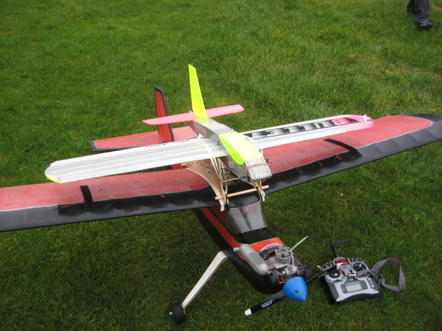

here's a few more pictures from todays flying
the bird of time fuselage was a little deeper than the albratross so we had to modifiy it a bit
« Reply #20 on: February 26, 2012, 17:27:13 PM »
three happy boys  :D  :D
the wind was a good bit lighter today and believe it or not the bird of time was easier to take up than the smaller fling  :clap:
no thermals  but we must of had about ten flights the shortest being the bullet  :lol:  :lol
