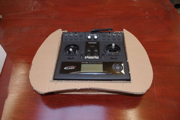

Stage one: Reduce, resuse, recycle:
Mockup produced in cardboard. 30 minutes or so of effort. Lots of notes now scribbled on the mockup. Actually did this a few weeks back, but some 'improvements' to the balsa dust factory slowed progress.
Material earmarked. Some scraps and some ply salvaged from a fancy wine box. More recycling. This will be painted in my trademark yellow when its all done (so that I can use filler and hide all my mistakes).
I got into the habit a while back of making sure all my ground kit was yellow. I'll still loose bits, but the yellow really stands out when I'm packing up to go home. I've not managed to lose a yellow item so far.
This will be disassembled into the relevant parts (tray top being the most important) and used as templates for the real one. Most likely the remaining pieces will be measured out based on the notes scribbled on the mockup.

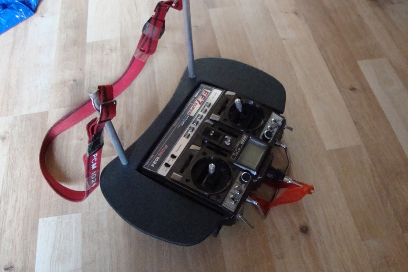

For the support, on mine, this is how it's done (simple and works great)

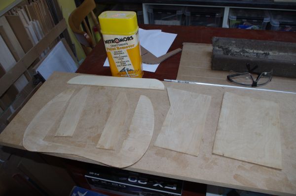

Ok, since I said I was recycling, I was running through my stock of plywood odds and ends. The biggest suitable piece I found came from a wardrobe, and is very definitely older than I am. The downside of this recycling is that the Nitromors had to come out to remove the layers of varnish applied at least 50 years ago.
Construction was in stages:
Stage one, cut out the platter, sides and rear piece based on the template and any notes scribbled there upon.

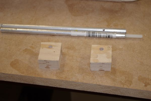

You can just make out the 'magic' pieces under the tray top. Here's a closer look:
These are more blocks of scrap ply from some project or another salvaged/sacrificed for the greater good. The centres were marked and then drilled with a 5 mm drill bit.

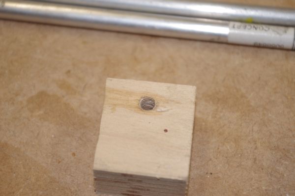

These blocks of ply were then firmly fitted into a bench vice and tapped, using an M6 tap, to mate with standard (long) M6 wing bolts. The M6 bolts were epoxied and pinned into the arms so they can be removed later.
The key to tapping plywood is runny cyano. After the thread has been (carefully) cut, soak the thread liberally in runny cyano and forget about it for a while. When the cyano has set (this can take a while, longer than you might think) clear the threads using the tap. Voila, an M6 'nut' of plywood. This works for many screw sizes, the only gotcha is that it works best if the mating bolt is nylon, rather than steel.
Here's a closer look. If you look carefully the threads are visible in the plywood.

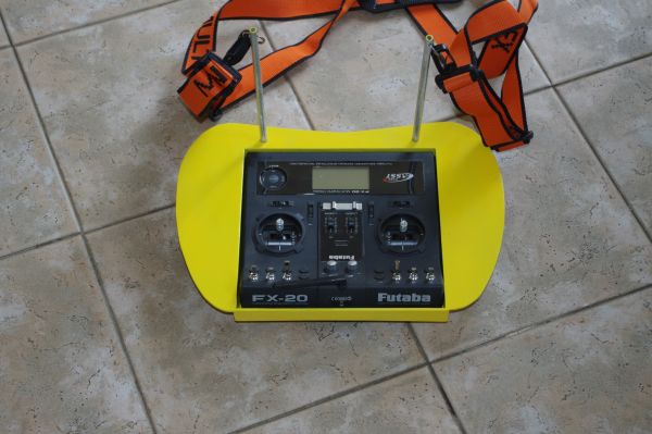

« Reply #22 on: July 02, 2013, 21:28:35 PM »
Finished item. ready to go
The fleet is now configured to work with this tranny and the 'sit' feels perfect. Now all need is the chance to crash, sorry, fly the models. I guess a crash is an uncontrolled (or should that be unplanned) landing.
Not sure anyone else will be inspired to try the genuine DIY route, but it ain't difficult, thats for sure :D
I based my dimensions on the Freds 'kit' photo as I was able to work out the approximate size of the 'wings' from the photo. In a moment of madness I thought there might be a scientific/ergonomic reason for the 'wings' of the tray to be a particular size. The rest of the design  used the tranny dimensions and the TLAR (That Looks About Right) design principle.
The biggest problem I had during this little project was with the rubbish spray paint I used (I'm trying to get rid of, by using, my various cans of rubbish paint. As everyone can gather, I'm too tight to throw it out and replace it with decent quality paint). I would have had that problem regardless of where the 'kit' was sourced :oops:
