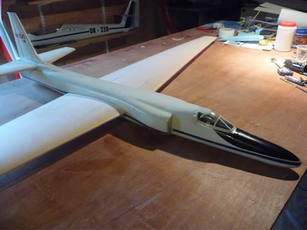

Pretty happy with the U2.It's and first plane i've built from a plan,the first fiberglass work i've done,the first foam wings i've cut.Lots of firsts really! It doesn't fly too badly and it looks ok too.So all in all a good introduction to building and to PSS.
Initially the U2 was way too tail heavy making the first two flights very interesting.the first being an immediate loop ending in a nose straight down dart like landing.This early test proving the fuselage to be quite strong and resilient.With way more weight added to the nose she was launched again,this time unfortuneatly the battery and the weight moved on launch causeing her to stall straight away.With the everything fixed securely in place it was time for launch number three.This time thankfully she sailed gently away from the slope.
After two flights i can say she flys pretty well.As Fred said earlier she doesn't need a gale to get going and can glide around gently in fairly light lift.As expected I'm using a lot of aileron differential and rudder mixed with aileron to get smooth turns at the moment.Will take a few flight to get her dialed in.Will have a little thinker with the incidences and probably lose a bit of the lead from the nose as it is a bit nose heavy still i think.
Just need to finish the paint job and add some trim lines and a NASA here and there and shes done.
There is a huge amount of satisfaction to be gained form starting with a basic plan and ending up with a model that flys pretty well.I've got the building bug it seems.Can't wait to start the next one!

Nearly There! Just a few more details.The NASA and the registration numbers and yes Fred a pilot!! :lol:  :lol:

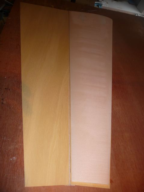

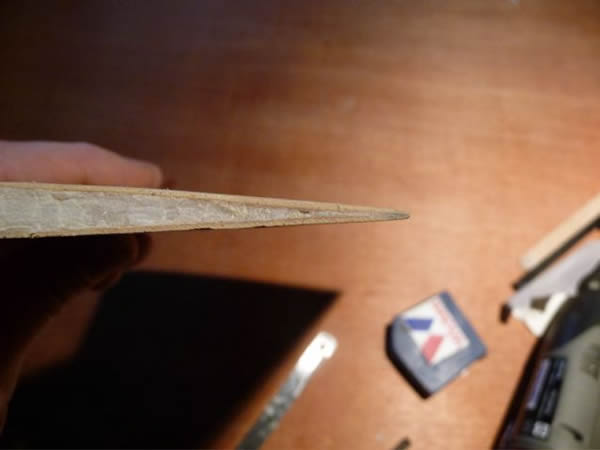

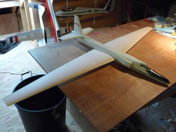

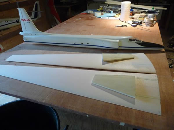

So three and bit years after it was finished I've decided to return to the U2. It was my first scratch build and it left a lot to be desired. The fuse is not too bad but the wings and stab aren't very good. I messed up on the wing joiner big time which changed the planform and gave it a slight anhedral as well. It flew OK but that's all. Needed constant flying as it wanted to tighten into turns. That'll be the anhedral I'd imagine.
So it now has two new wing cores with joiner fitted. Correctly this time, I think. I went for a RG14 second time for a faster low drag wing. It has plenty of wing area so should still go well in medium lift. I hope?
New stabs cut and and skinned. Used my vacuum pump for the skinning. Makes a big difference and with some fibreglass you can get a nice strong, straight and thin trailing edge.
Anyway, here's some photos.

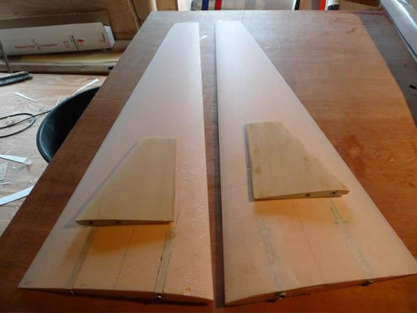

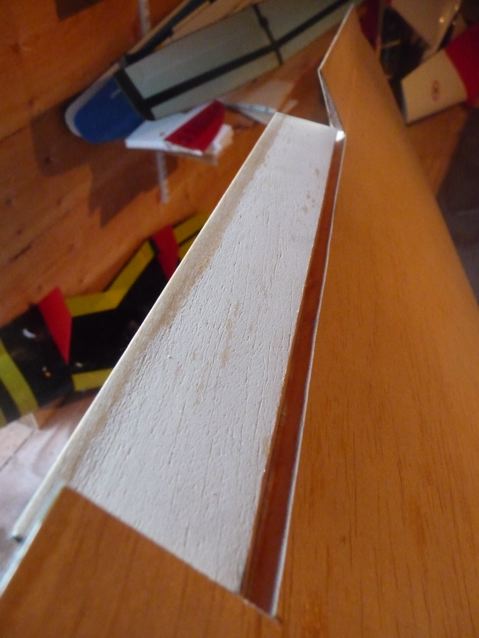

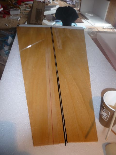

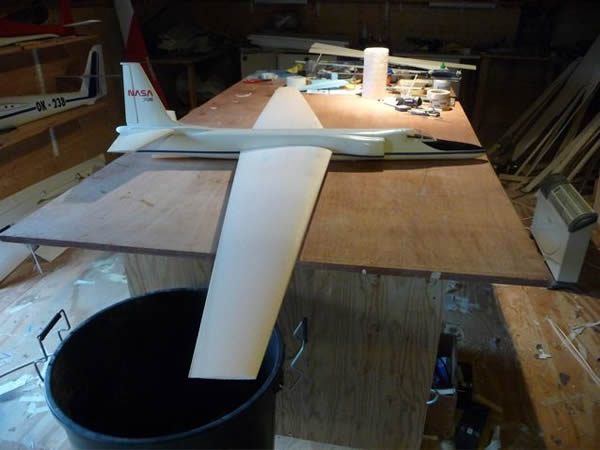

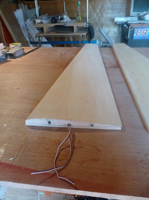

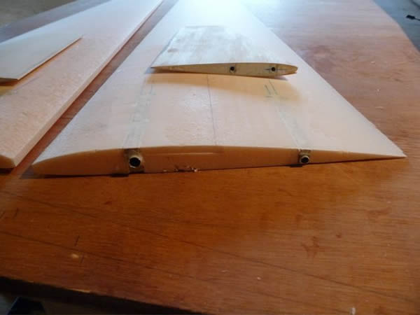

Got a bit more work done on the U2 replacement wings. Could of done a few things better. Will know next time. We live and learn. Not bad though for first vacuumed wings.

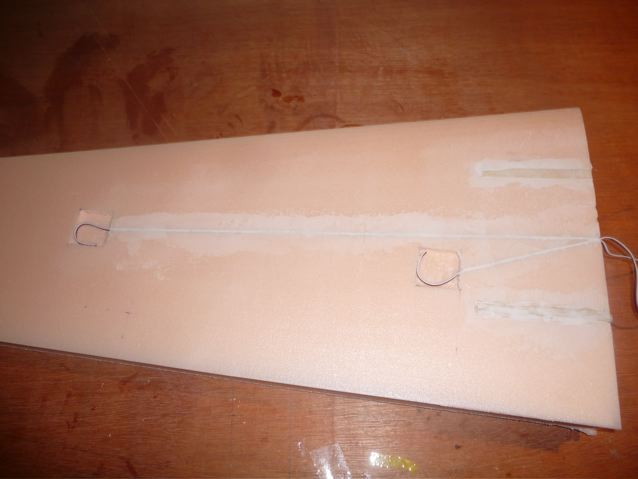

Servo bays cut and wire in place. I did it the lazy way.

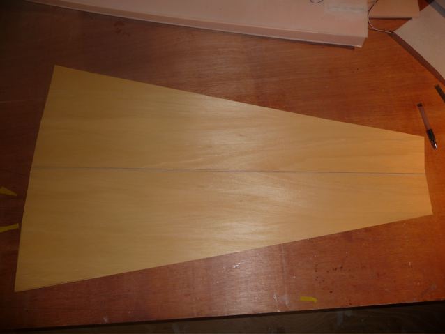

Skins cut to size.
The the wing sandwich.

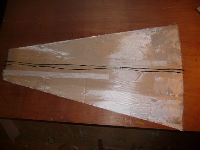

Glass cut and ready.
All wetted out.

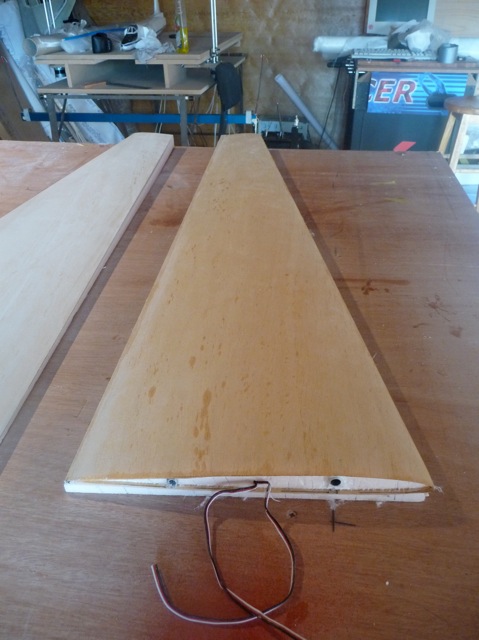

Out of the vac bag.
After a bit sanding.

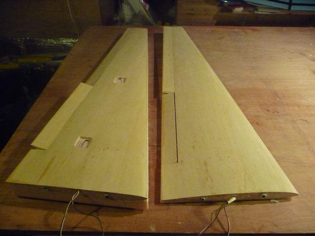

Leading edges glued and sanded. Ailerons and flaps cut free. Live hinges using peel ply. We see how they last.
