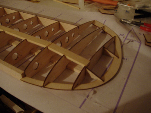

The wing tips are done. the upper spar has been cutted to stick to the last 2 ribs. The gap will be filled with epoxy. The 2 triangles at the end are for the tip reinforcement... I'm a bit affraid that will bend during the covering (I will use Diacov from Diatex...Really strong !)

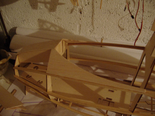

And the cockpit frame is on the way.... slowly but surely ! You can see everything, so, that need to be detailled ! The nose cone is not glued yet.. I have to make a tow release mechanism first....

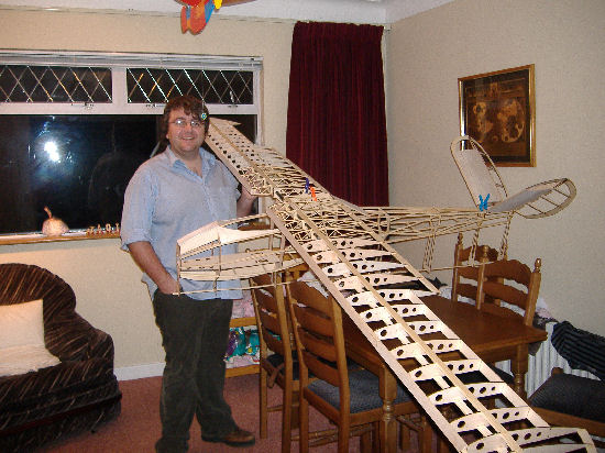

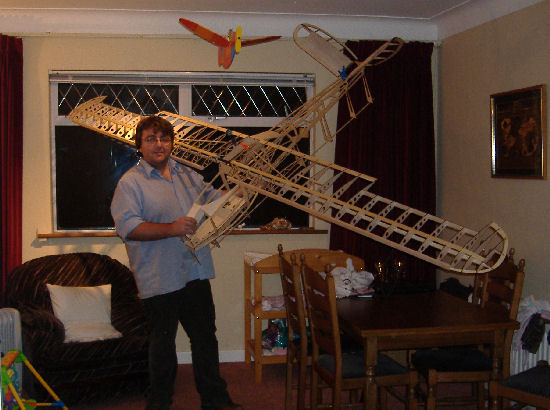

Well... Moving on ! Yesterday evening was the first real assembly of the beast !
Well.. That is huge ! lots of volume... Can't wait to see that thing in the sky !
Left to do : Wing sheeting, fuselage nose cone, install the radio, airbrakes, ailerons, covering !
Getting there !

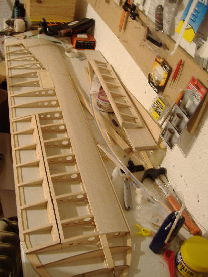

So, here we go :
The wing sheeting is made from 2mm balsa. No real troubles here ! A balsa striper is used to make the 10mm wide strips for the ribs.
Good to be back !  :D
