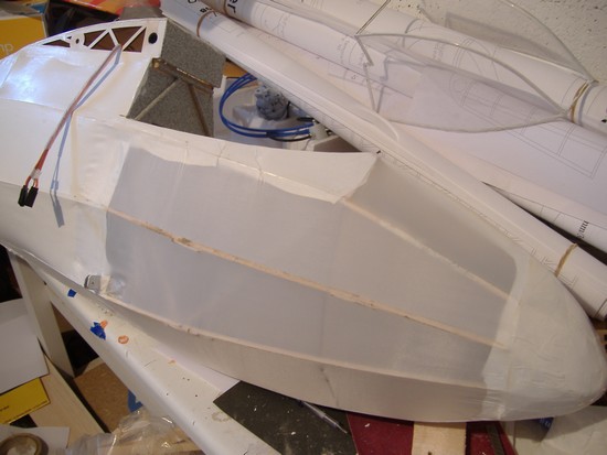

All done now !
Here is the (almost) finished result...
Still a few wrinkles, but you can't really do it much better...
The best solution at this stage would have been to re-cover the entire fuselage... But no time, this is a big piece to do, and Retroplane is near us !

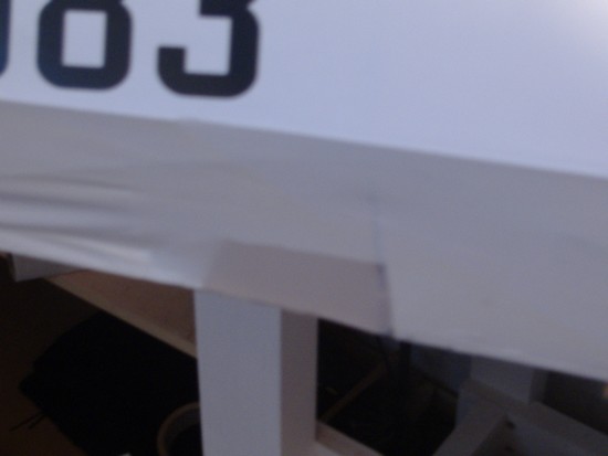

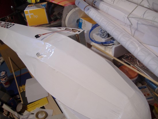

But finally, after a layer of paint...
The result is quiet good !
Can't see a thing 1 mtr away...
Second layer is coming soon, and that will be the final touch !
Gliser ready to go again !  :D
