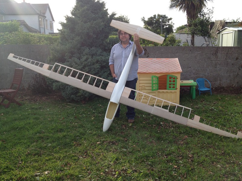

I have to weight it at this stage, as the fuselage feels very heavy  :?: But I am really happy with the wings!
A few photos to give you an idea of the size (4.3m)
Not too small, not too big, perfect to bring everywhere with you  :D
Stay tuned for more  :D

nice bit of work Fred and that's a nice size of model  :clap:  :clap:  :clap:
Pilatus B4
« Reply #18 on: August 20, 2012, 20:46:19 PM »
Great work Fred :D :D . Looks like a nice size. But are you not going to sheet the entire wing all the way back to the trailing edge  :?:  :?:  ?
Pilatus B4
« Reply #19 on: August 20, 2012, 21:35:21 PM »
Tres cool.... 8)
Pilatus B4
« Reply #20 on: August 21, 2012, 08:01:50 AM »
Thank you all :)
Alan, sheeting will stop at the spars (D box), more than enough.
Frederic

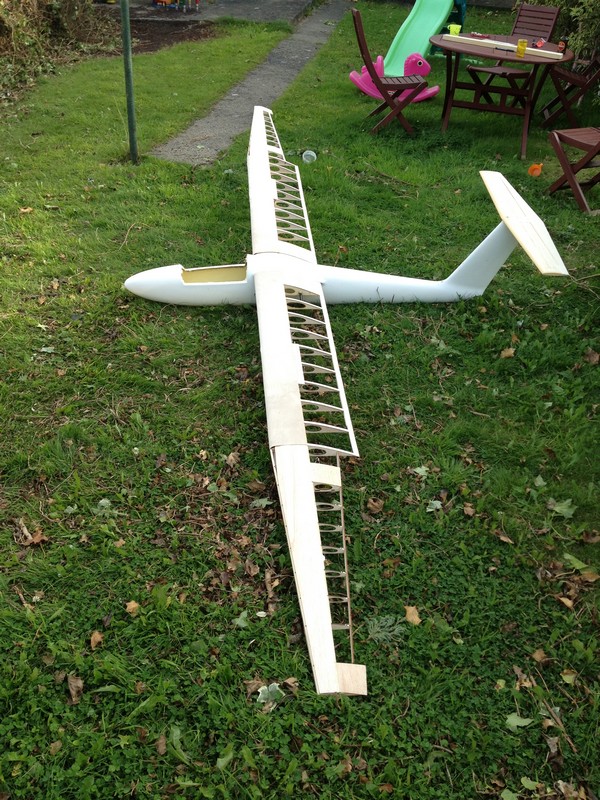

« Reply #25 on: August 28, 2012, 21:23:32 PM »
Alright, small progress!
But that thing start to look like a glider! That need a bit of room to setup!
For the wings, just the ailerons to be done and hook them up (airbrakes are in and setup)
Fuselage.. Rudder, servo tray, and still waiting for my canopy  :!:
So, lot of work still left, but not too bad at this stage for only 2 weeks worth of work  :D
Oh, and I am gutted!
Built a Fuselage jig to setup wing joiners etc etc... Drilled holes and so on.. Put the wings on the fuselage.. And not straight!(viewed from the top, other axis are fine) By 5mm  :!:  :!:  :twisted:  :twisted:
Checked the Jig, and looks like one of the side slided while the glue was drying, certainly because of the weight of the clamps  :!:  :!: Did not pay attention  :!:
Jig now destroyed, and will be burnt at the next BBQ!!  :x
I use a floating key, so too much work to rectify it, I leave it like that for now, nothing that some white tape cannot hide!  :P  :D
