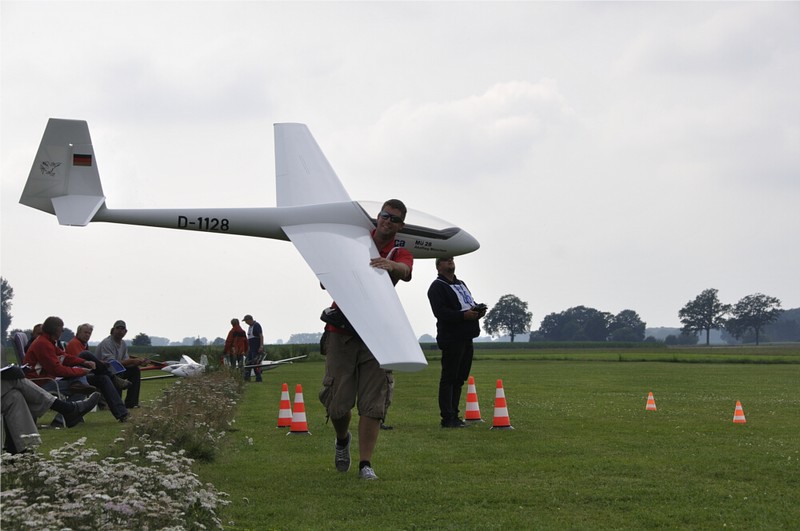

Was browsing the Interweb, and found this...
Motivation back?  :mrgreen:  O:)

Just turning to Freds picture, it does look a quite magnificent beast! (The plane I mean, not the guy carrying it ) :roll:
