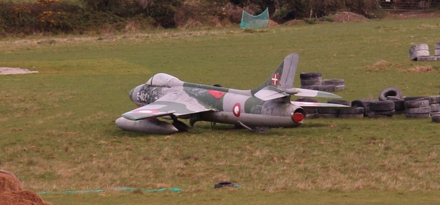

Just came across this photo on the hobby king forum, of a full size Hawker Hunter laying in a field at a paint ball centre near Dublin, should be in a museum, what a waste!
This hunter is located at Puddenhill Activity Centre, Moorepark, Garristown, Co Meath.

As for the full size Hunter laying dormant :cry: ………….Are you sure it’s full size? It looks rather small to be full size relative to the tyres in the background. Of course it could just be that the picture was taken with a telephoto lens and depth of field has been lost.

Agree with Keith about the relative size of the "full-size" to tyres, (miracles will happen, a Scotsman agrees with an Englishman!!).
Also noticed though that it has a cover in the jet pipe, which I've never seen on anything other than full size?

It looks like a model due to the photo's angle when taken, however, it is a full size hunter. here it's history:
E-402 Hunter F.51 Royal Danish Air Force
looking the worse for wear at Puddenhill Activity Centre, Co.Meath, Ireland.
This Hunter was retired from Danish service in 1976 and went to the Bournemouth Aviation Museum in 2000. It moved on to the Farnborough Air Science Trust in 2002 before it eventually made its way to Puddenhill in late 2006 - where it will most likely end up being scrapped.
also link to another photo : http://www.flickr.com/photos/eigjb/4427198408/

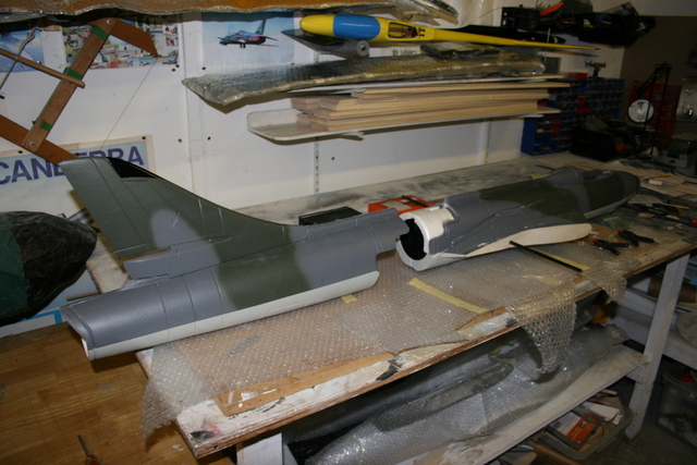

O.k I did a little work today on the Hunter, I decided to build the fuselage in two section, with the wings, now removable. The tail section will be glued in place and filled with light filler before the glass cloth is applied to the whole fuselage, which after a lot of cutting and twisting, is now solid.
I added some carbon rods to support the wings which in the kit had very little, also I managed to pick up the paints today from B&Q, great mixing service and cheap.
The fuselage, which is now in two sections, compared with the original six twisted sections :lol:

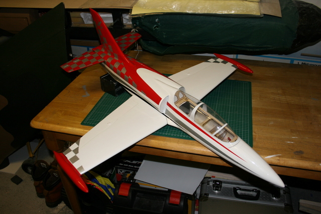

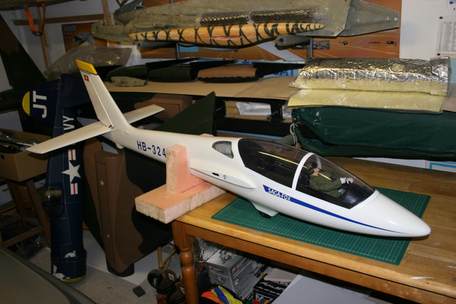

A little behind with this build at the moment, so I may not have it ready for BigL, however I do have the MDM Fox repaired and ready to go and also a new small L39 ready for test flight  along with the F14 for the fly in at Big L.  :P
3m mdm Fox ready to fly again.
Small L39 glass fuselage and foam wings.

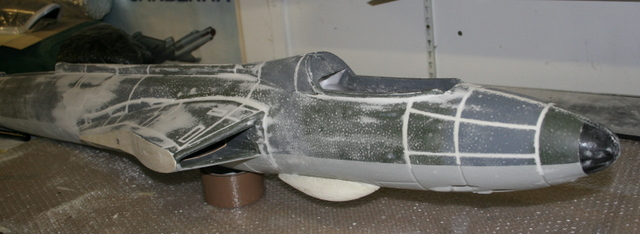

HI, just did a little work on the hunter tonight as follows:

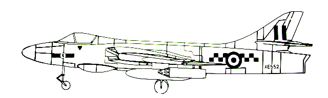

I build the fuzelage and have filled in all the big thing so called panel links which are carved into the kit, using light filler. next the glass cloth will be applied
Drawing showing the side blisters on the Hunter.

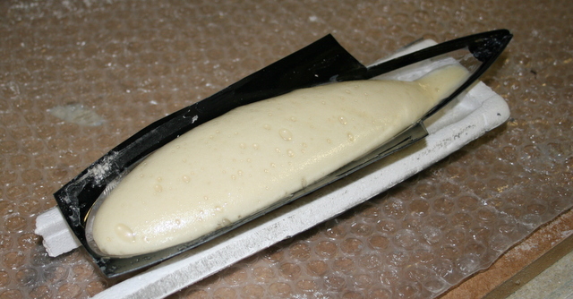

The Hunter which i intend to model, has the side blisters on the bottom of the fuselage, however, the kit does not have any parts included, therefore I had to make a set using a small F16 canopy as a mould, and a two part foam solution, which when mixed, expands and forms a very hard unit.
Process of making a set of foam parts.

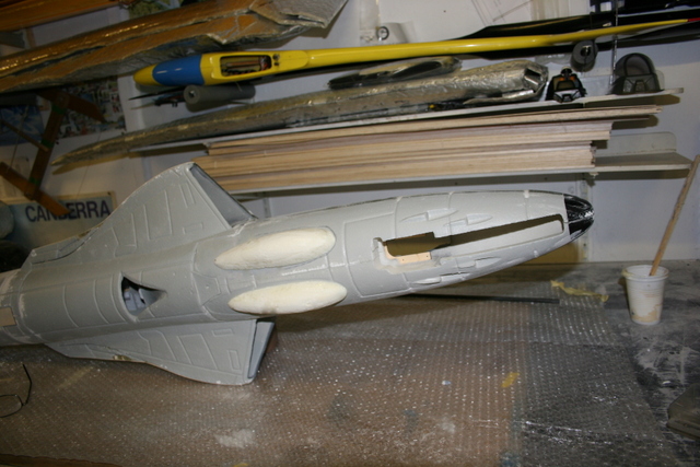

Parts pinned in place, the outline on the fuselage is far to big.
Fuselage ready for glass cloth and Poly-C.
