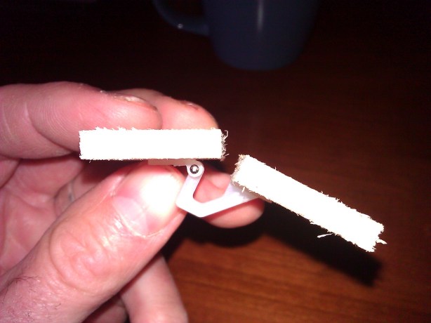

Very good Keith  :clap:
For  your hinges problem, do what Bill said, tape on the back, and your problem should be sorted  :D
Option B, would be to use "flap" hinges, like the one I use on the Ka3 (same type of airbrakes).
Come in various size and shape, but all the same funtion, to move the hinge axle back (sorry, can't find the English word for that  :!:
Liek the photo, but the other way if you see what I mean.
The one on the photo are the one I use.. If you need some...  :D

That’s interesting Fred. I’ve never even heard of Flap Hinges. I’ll try the double taping first. Thanks :clap:
