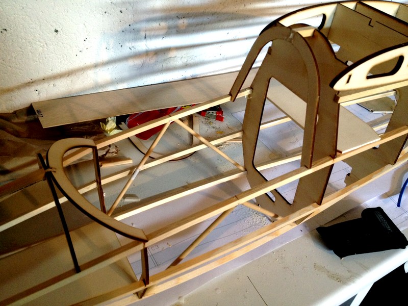

Anyway, started to add a bit of "scale" details there and there, and the tube structure in the front, along the canopy frame etc.
Fuselage almost done  :D
Left to do is the nose cone, and the sheeting at the front.
Mounting the rudder servo and push pull system.

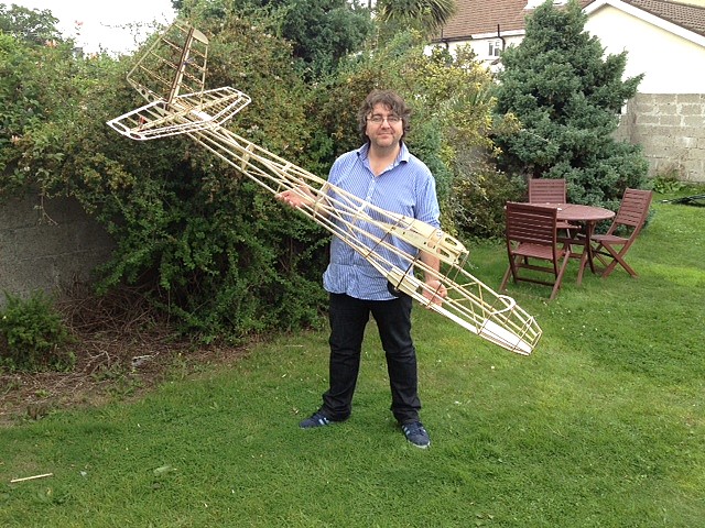

Ok, a bit more work done this afternoon  :D

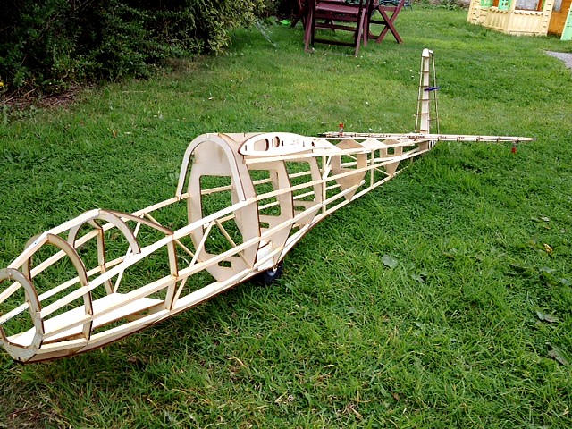

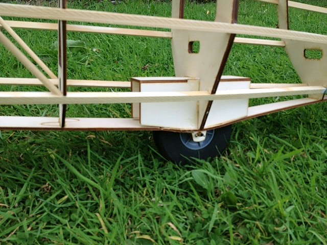

Removed the fuselage completely from the jig. Always a great moment for me  :D
Time to glue the fuselage bottom, that will also be used to support the skid and the hook for the bungee.
This is made with one long piece of 3mm plywood, with the opening for the wheel (110mm diameter in my case). The wheel support is as per the full size.

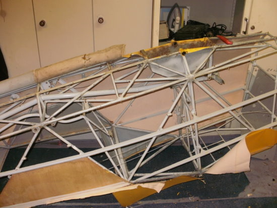

The reference:
And out in the garden  :D
The beauty and the beast... Will not tell you which one is which!  :lol:  :P  :P
So, basically, fuselage is pretty much done.
I'm off South for work this week, so no more work will be done until next week end unfortunately  :!:  :!:
Also ordered the tube and rod for the wing (23mm tube, 20mm wing joiner).
Wings should be fairly easy to build, plan is printed, parts are waiting!  :D

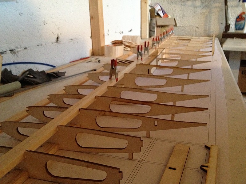

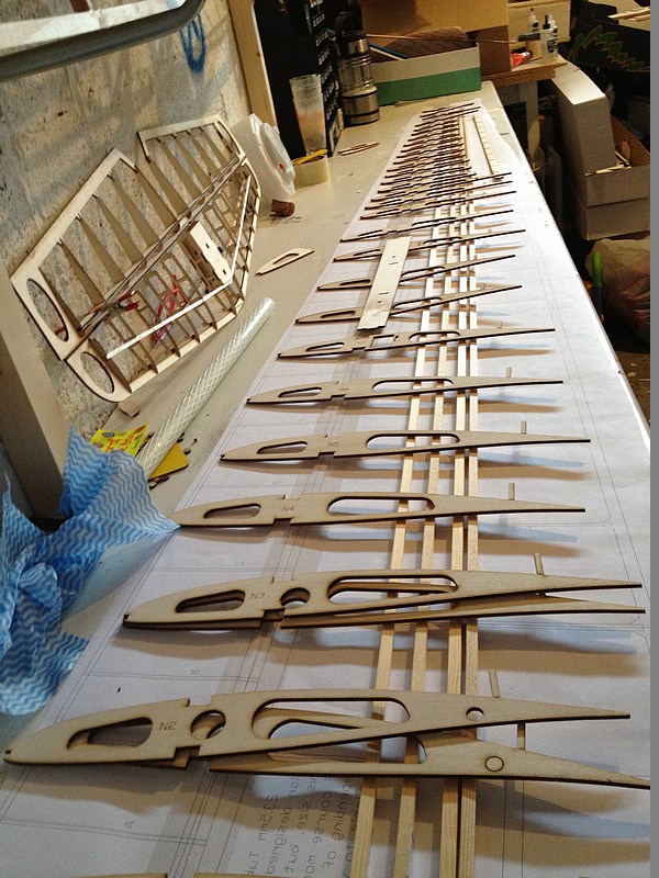

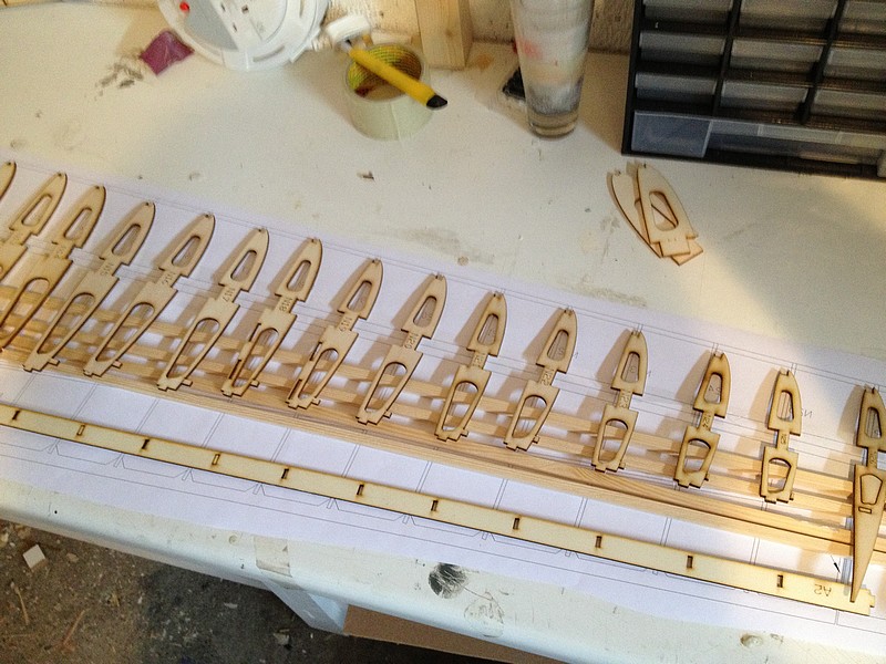

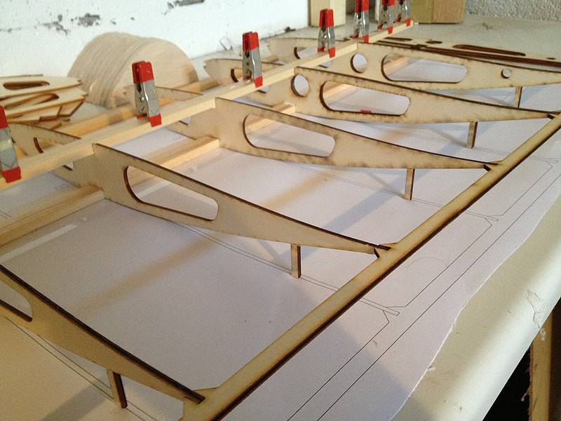

After a week away from the workshop, it was time yesterday to glue some wood again!  :D
This time, with the wings.
So far, so good, no issues and my workshop was, for once, clean enough to start the 2 wings at the same time.

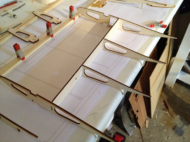

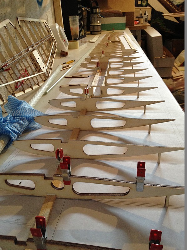

Anyway, nothing out of the ordinary. Spars glued first (I used 2x8x8mm pine wood) and then, the ribs glued to the spar, starting from the root to the tip...
Everything is glued with white glue.

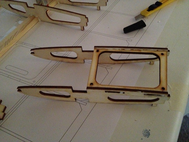

Some "modules" like the airbrakes support and the servo boxes are built apart, then glued on the spar (classic!)
After roughly an hour, the white glue was dry enough to glue the top spar.
And as a preview, here is a quick look at the next steps, the trailing edges.
Start to look like a wing!
