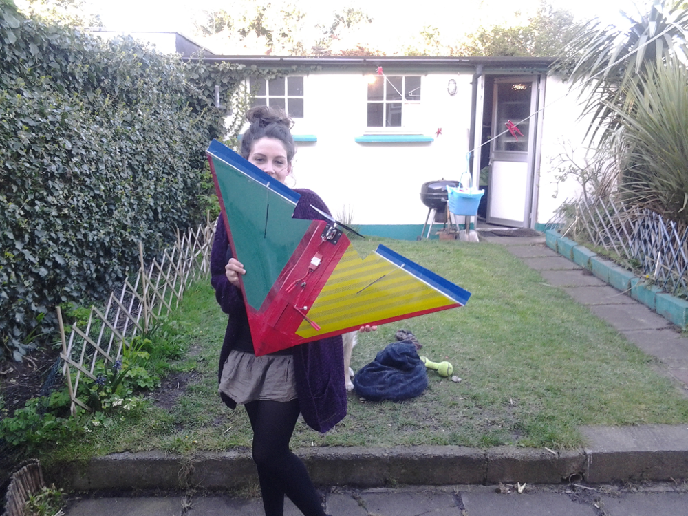

Just finished this model today, plan from here Mugi evo. The original is 800mm wingspan but I decided to scale it up to a whopping 1000mm  :o this model goes together really fast and even as quite a slow builder it only Took me about 4 hours. I could have done a better job but not getting too much time to hobby these days, lets hope it stays in one piece long enough to get a maiden flight out of her.
As there is currently an outright ban on spending model tokens in this house everything had to be made from already available parts. Construction is all 2mm correx and tape, 2836 1500kv motor, 40 Amp esc, 9 gram metal geared servos and a 50c 3 cell lip. It should go as I recently had this motor on a model twice the weight and that was quite fast  :twisted:  :twisted:
Here is a pic along with the instigator of said model token ban.
