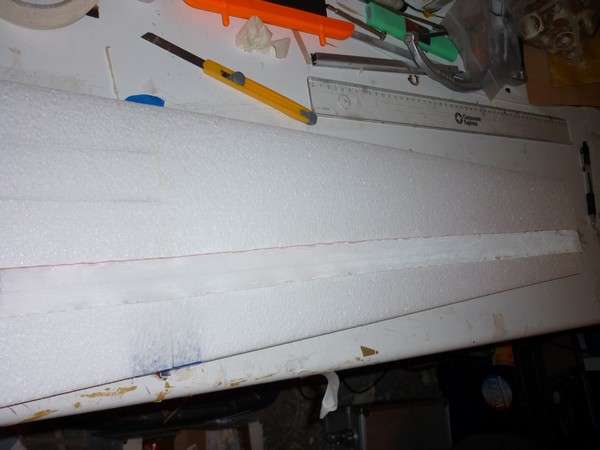

I pass the balsa cutting etc etc, and here is the foam core with the tape for the live hinge.

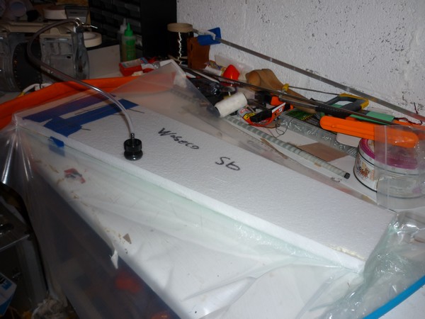

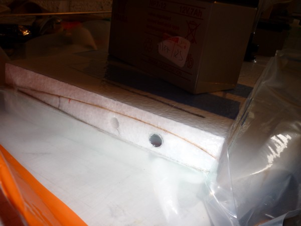

Then, everything is bagged... I always put some cling film between the wood and the foam cores. Nothing stick to it... Just in case  :roll:

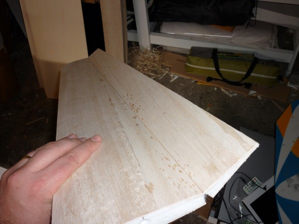

Once dry, remove evrything from the bag, remove the cling film, and sand everything smooth, time to do the hinges.

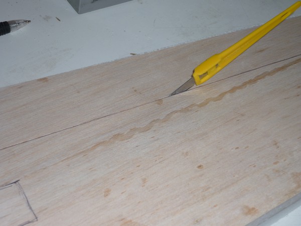

Small cut on top (1mm wide), and a bigger one at the bottom, in a flat V shape, et voila !
And gluing of the TE

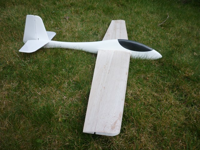

Now, servos are in, TE sanded, and incidence pins glued... Covering tonight, and job done !
All in all, without the epoxy curing time, 2 hours spent on the wings to have them ready to cover  :D
More photos once dne  :D

Fred, you said you put some cling film between the wood and the foam cores. I assume when you say “wood” you mean the  balsa sheet? In which case surely you would want the wood to stick to the foam core :?: ……………..wouldn’t you???
(Or am I just being exceptionally stupid today :oops: )
Wasabi Eco - Building Thread
« Reply #20 on: March 21, 2010, 19:06:34 PM »
Hey Keith,
Yep, that's between the balsa and the foam.
Foam
Cling film
Balsa
Foam (wing)
Balsa
Cling film
Foam
That's in case some epoxy goes through the balsa because of the bagging. I have a few spots of epoxy on the sheetings despite removing almost all the epoxy from the wing before putting the sheeting !  :!:  Don't look good on the photos those spots, but the surface is smooth...

Forgot to post a photo, before covering...  :roll:
All covered now, and 1 servo link to plug, and ready to fly...Again...  :D
