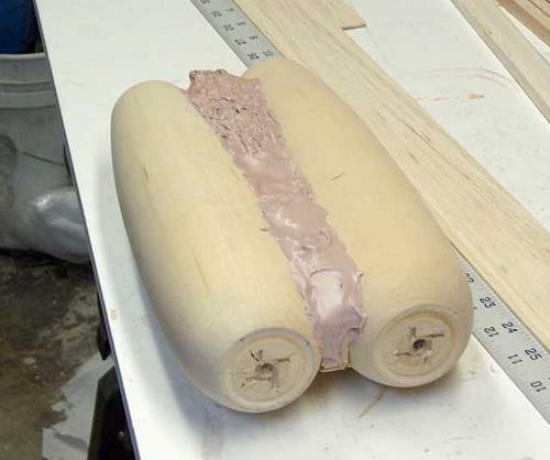

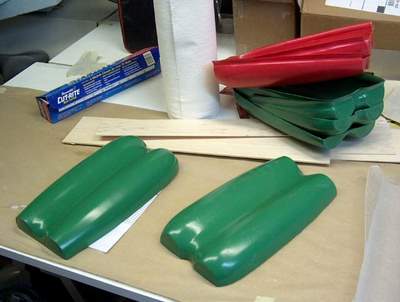

I was thinking if I could get 2 engines turned on a lathe, then I could join them and add fillers to the center section. D.Cairns from the USA, used the same setup on his fantastic B52 here are a few pics from Dave's RC Groups build log :
Engines produced on a lathe then glued and filler added.
Vacuum formed in plastic
These pics give you an idea of what I am try to do

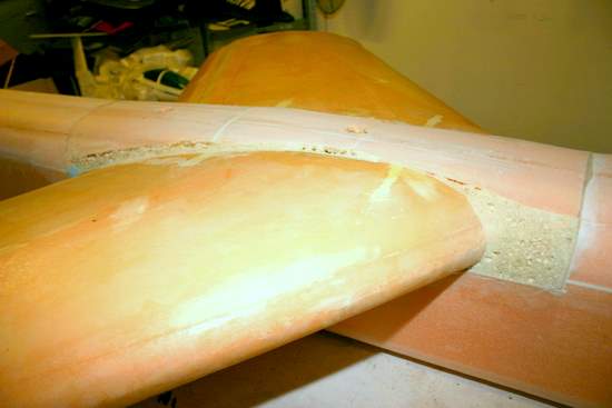

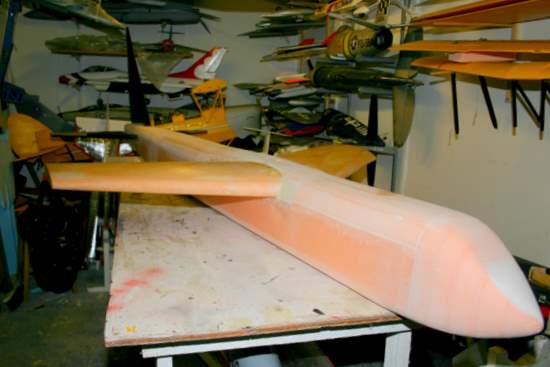

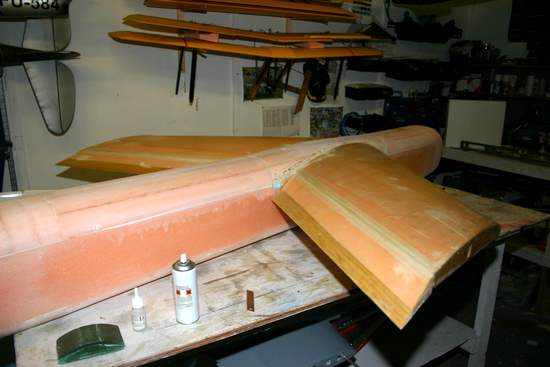

O.K. well here are a few pics of the work so far, as the photos show, I finished the center section over the weekend and fitted the tall and fin sections in place. I used expanding foam to fill up the gaps in the wing seating area and shaped to suit the front fuselage area. I will finish this off with light filler and sand smooth.
I did not glass the fuselage as planed over the weekend due to a few cracks discovered at the tail, therefore I will have to strenghten this section from the inside with ply and glass cloth, better to be safe than sorry!!.
Expanding foam used to fill in all the gaps around the leading edge.
Photo  shows the flaps in the landing position.
