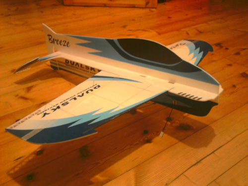

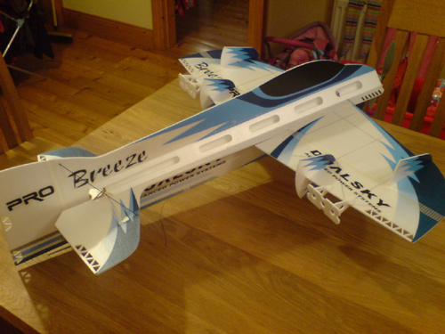

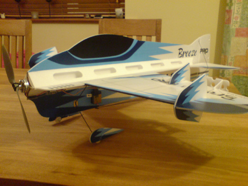

« Reply #5 on: November 09, 2009, 23:01:29 PM »

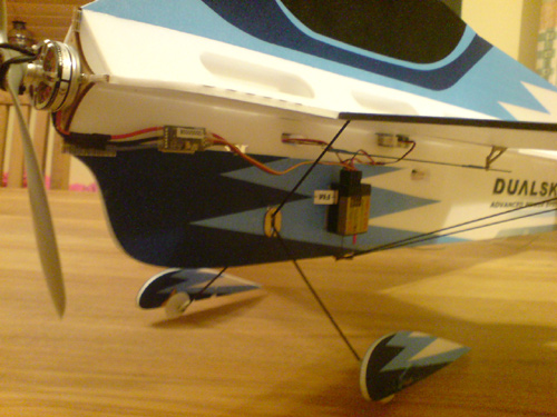

Just a few pics of the finished Breeze.  :D
Came out at 150g. I opted for 3 cell 250mAh lipos for power. APC 8*3.8 prop. 80W Motor.
Looking forward to having a go. See you in Middleton. :D

« Reply #6 on: November 10, 2009, 09:18:32 AM »
Hi Dave,
What kV is that motor ?.
You might consider a GWS ,or some other rubber,propeller.
We had our first go at this on Sunday and it takes getting used to.

« Reply #7 on: November 10, 2009, 09:41:52 AM »
Brian
The Motor is 1780kV.
The power system allows the model to climb vertically out of my hands at half throttle. Maybe a little overkill?? I am not sure. Never flown indoor before. Will be very interesting. I enjoyed building the model as a new experience. I am sure the actual flying will be fun too. Hopefully I can keep it in one piece for at least a couple of flights anyway.  :?:
