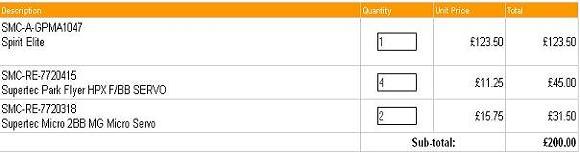

good 2.5m+ sailplane - which one ?
« Reply #17 on: January 13, 2010, 15:21:06 PM »
- Spirit Elite
- MG servos for flaps only

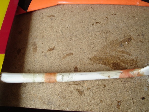

Hey Dennis Glad your plane has arrived. Allow me to tell you a little tale about using flaperons. :!:
The picture at the end of this posting is the fuse’ of a little mouldy I have. There are a total of 5 breakages’ along it’s length. :(
I couldn’t understand why this little Filip 400 would often come into land nicely, then suddenly drop one wing and cartwheel along the landing area, breaking the fuse with the inertia. :cry:
Then I was then told about the effects of “Wash-in” and “Wash-out” at the wing tips. :?:
The end result was that instead of using the ailerons as flaperons when landing (Which increases Wash-In) I was told to make both ailerons move UP to become Spoilerons. This increases Wash-out which tends to stop the wing from tip stalling. :D
Result: Perfect landing every time! (Well………nearly perfect. Well,………..landings without damage, lets say that! :oops: )
You might want to bear this little story in mind
Oh, by the way. The Filip still flys, although not quite as well as it used to !!
