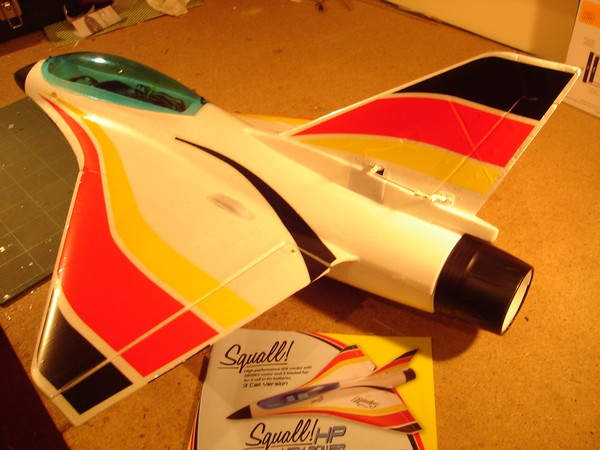

Apart from a few obscenities when searching for some servos for the model, and when I found some, I then couldn’t find the correct type of servo arms! :!:  the build went reasonably smoothly.
A most Excellent idea to use hot melt glue, and a great tip of turning the gun off for a couple of minutes every once in a while. Thanks guys. :D

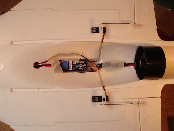

Couple of things surprised me a little about the workings of this EDF. (Having never had one before.)
I hadn’t realized this until I came to fit it, but the motor is an out runner.  The book says it’s a 3400KV, that’s 50000 rpm with a 4 cell battery. Seems a very high speed for an outrunner, phew!
Also inside the air intake, (This next pic. Shows the underside of the plane without the bottom of the air intake fitted, Would that be called a belly pan?) there are a load of servo/motor wires. I’ve taped them down as advised but I would have thought they are going to cause quite a bit of turbulence. :shock:  I’d have expected a “cleaner”/smoother intake area. What do you Jet guys think?
Anyway, here she is, all finished and ready to rock and roll.

Yes you are right about the little motor, it will get hot, therefore you can slow her down and cruise about at times during the flight, this will let the motor cool down. Don't let the model get to far away, because as you said, it can become  hard to see, keep her in close with low passes and big loops.
I noticed you taped the wires inside the model, make sure that the tape is good heavy tape, as within the air intake, there is a lot of pressure, and the tape could lift off the wires and go into the fan unit and damage the blades.

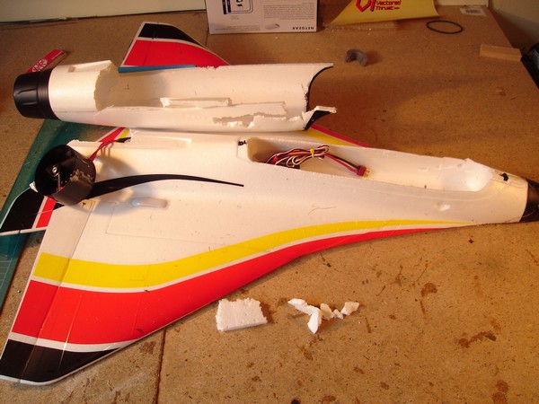

After the second flight I picked up the model and started walking it back to the car to recharge the Li-po.
Slipped on a tuft of wet grass…….. :evil:
Lost my balance……… :shock:
Fell Base-over-Apex, (arse over tit)……. :?
Landed on top of the model!! :!:
Heard several Crack sounds…..!!! :cry:
Oh well, another little job in the workshop..... :cry:  :cry:  :cry:
