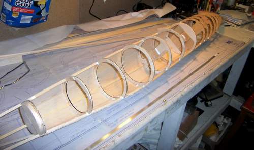

« Reply #21 on: October 27, 2010, 23:01:29 PM »
Hi Ron, yes it's easy to get side tracked on this forum.
Well I have managed to get things moving again ( weekend panic with the family!), I have started sheeting the fuselage and hope to have this completed by the end of the week. The plans state that this sheeting should be done with lite ply, however with the poor supply of balsa and ply up here in the North from model shops, and the increase in postage costs from across the water, I have used lite balsa, which will be glassed later for strength.
Progress so far, start of sheeting on fuselage.
I will update later this week,
  JohnP
