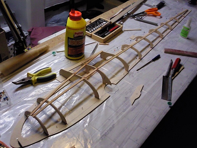

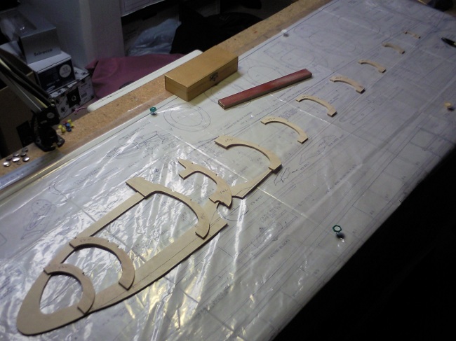

« Reply #19 on: November 19, 2010, 14:25:10 PM »

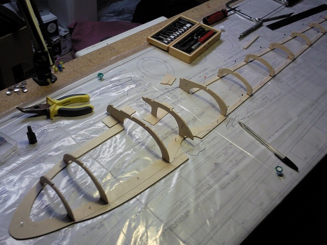

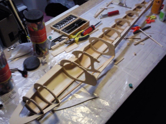

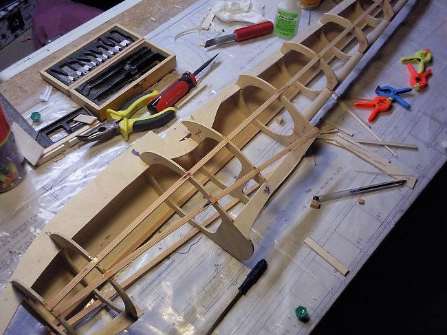

Finally started some construction. I'm starting with the fuselage. According to the RC Model World magazine article on this plan, the Fuselage is supposed to be built on a jig in one piece (e.g. using whole formers not half formers), not sure if you understand what I mean. But there was no information in the article or the plan as to how the formers were to be attached to this jig or how they were to be aligned. So after much head scratching I decided to build the fuselage in two half's.
Ron
Slingsby Skylark 2
« Reply #20 on: November 19, 2010, 18:40:07 PM »
Hi Alan,
Nice job.
Can't think how you could do that fuselage on a jig.
Wonder how they did the full size one in the factory :?:
If it was a boat the keel would have been set up first and the frames fitted to that at the appropriate angles.
I guess the keel could have 'legs' down to the baseboard to keep it at the right height, and maybe even fit the legs into slots in a jig to hold it all up.
Bit of a procedure I would have thought.
Great work though. :clap:
Ron
PS. What's that glue?

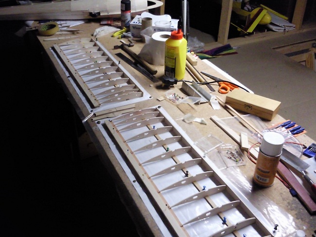

Slingsby Skylark 2

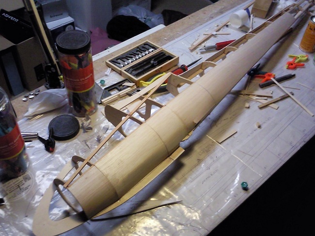

« Reply #21 on: January 06, 2011, 10:01:18 AM »
Happy New Year All.
Finally warmed up enough to get some work done. Photos below.
Ron: The glue I'm using is some sort of French white wood glue that I got at Retroplane. It's called Pattex I think, I'm sure Fred will know exactly what's it's called. It seems pity good.

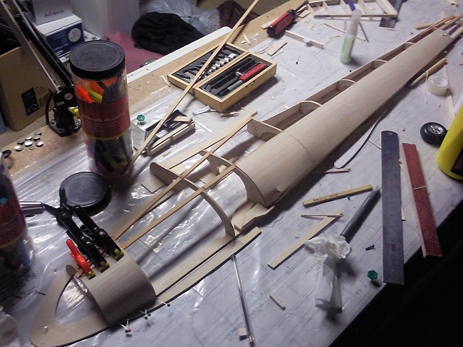

« Reply #22 on: January 06, 2011, 19:16:34 PM »
Very good Alan!
Sheeting in plywood ?  :?:
Retroplane glue, very good stuff indeed !  :clap:
Slingsby Skylark 2
« Reply #23 on: January 06, 2011, 19:42:25 PM »
Hi Fred.
No I'm sheeting it in balsa. The area around the cockpit and where you hold the fuselage when launching will be reinforced with extra sheeting on the inside to stop it getting crushed, at least thats what the plan says.

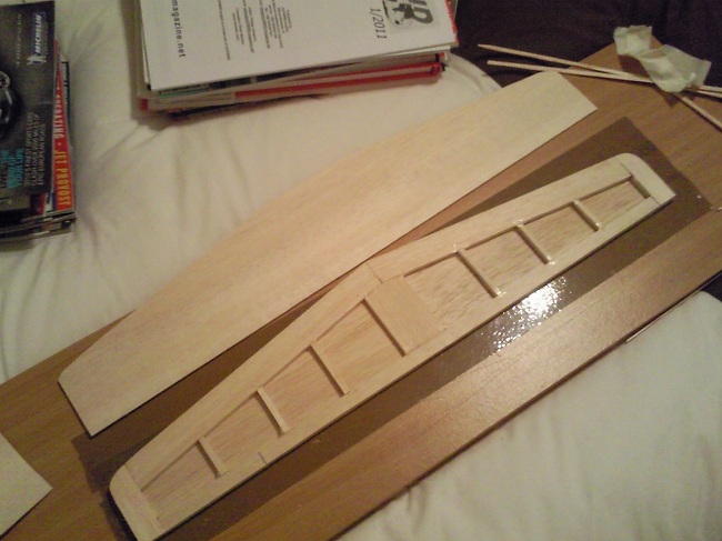

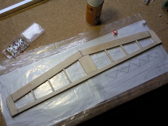

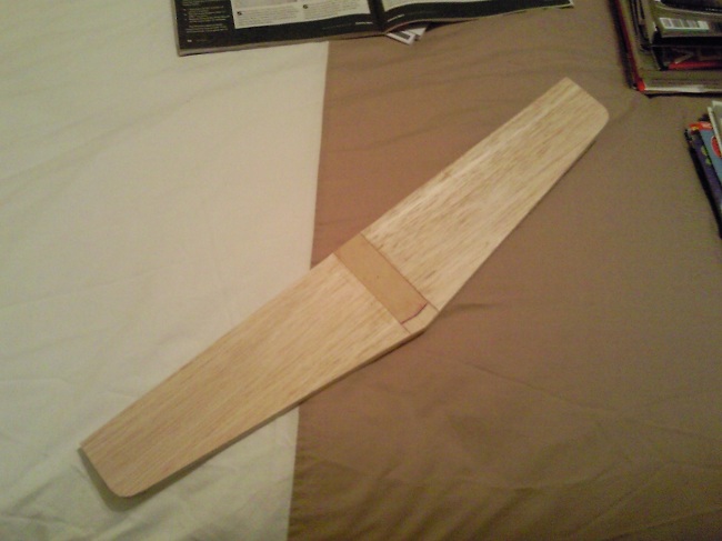

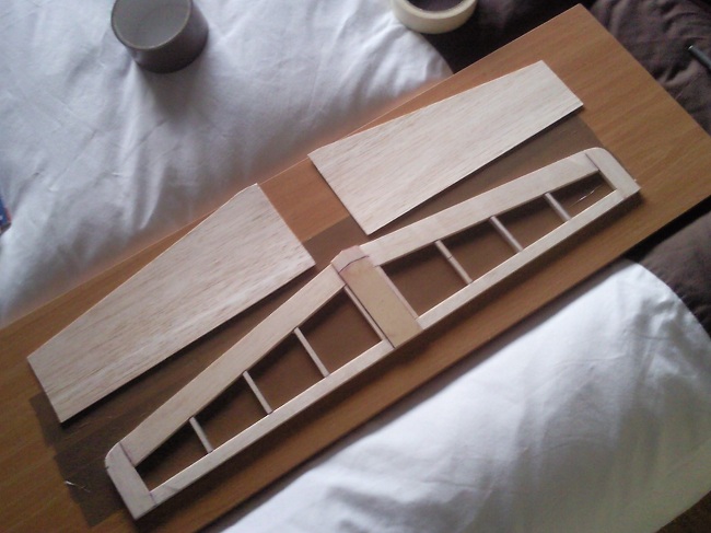

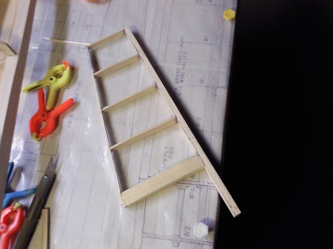

« Reply #24 on: January 17, 2011, 18:47:21 PM »
Another update. I have built the tailplane. Again I have deviated from the plan. The plan called for a solid balsa tailplane. But to try and keep the weight down at the rear I decided to make a built up tailplane sheeted with balsa. Hopefully that will reduce the weight at the rear-end a bit meaning less lead in the nose. Photos below.

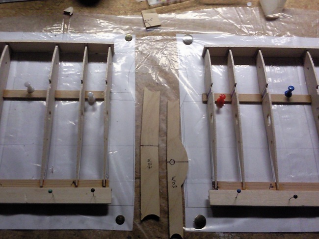

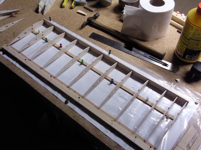

« Reply #25 on: February 06, 2011, 12:42:59 PM »
Hi All.
I have started work on the wing center section. It's built in two half's and joined together later as there is a dihedral angle built into it.
Here are the dihedral brace's
