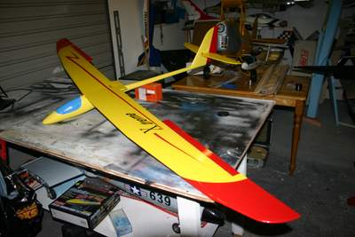

Just purchased a new model from Puffin Models (www.puffinmodels.com) called the X-Treme, a so called slope hot liner. I will keep you up to date on this build over the next week, so to get started, here are some details on the model:
The X-Treme has a lightweight epoxy glass fuselage, foam wing skinned in wood veneer bonded with epoxy, and balsa tailplane finished in polyester Oracover. The wingspan is 2.3m and uses the RG15 wing section. The two piece wing has both the ailerons and flaps ready hinged. The tail uses an all moving cruciform tailplane, unlike other hotliners.The X-Treme has a functional rudder allowing true stall turns to be performed, along with other manoeuvres that require the use of rudder.

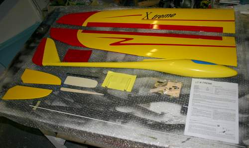

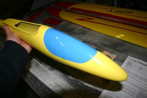

On opening the box, the model was very well packaged, with the small parts taped to the box sides (good idea). The quality of the kit was very good, with a good finished fuselage with carbon strips on the high stress areas, also a great set of wings with a fantastic finish. Here are a few photos of the model:
All the parts that come with the kit (ARTF kit)

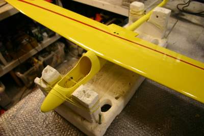

Closeup of the fuselage
I think this could be a quick build, opened tonight ready for Sunday  :?:  :?:

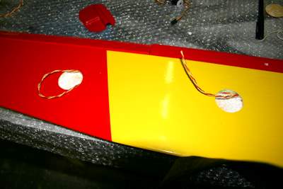

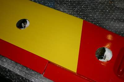

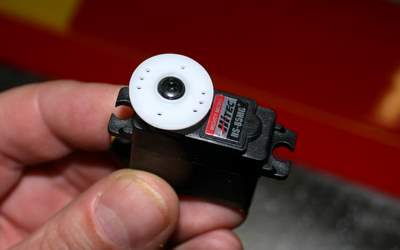

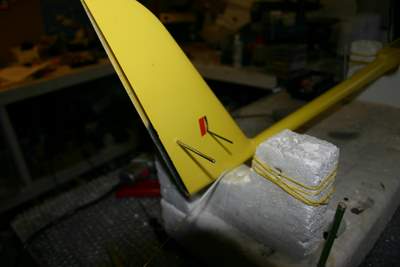

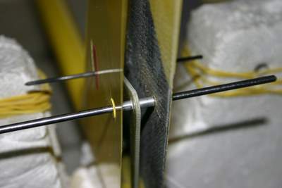

Well, I got a little work done on the X-treme tonight, with the mounting of the servos into the wings. I used Hitec’s 82MG 's 3kg, which fit perfectly into the thin wing section. The only problem which I encountered during this process, was the size of the servo wire channels, the tube was very small, so much so, that I had to run the servo extensions down the tube without the plugs, then, I add these to the ends of the wire when complete. The only other change I made from the plans, was the fitting of different control surface horns, to those supplied with the kit, I did not like how they fitted onto the surfaces (two spikes and some glue).
O.K. some pics
update soon!!

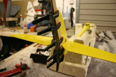

Worked on the model over the last few evenings and I am glad to say, that she is finished, well almost, just the radio to set up.
The rest of the build was straight forward, after finishing the wings and drilling the two holes in the fuselage for holding the wings on.

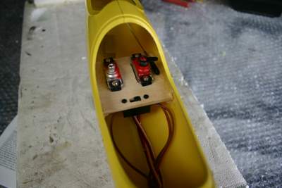

The servo tray was fitted and two MG16g servos added for the elevator and rudder.
The kit provides two snakes to operate these two control surfaces, however I only used one snake, for the rudder and decided to use the old balsa control rod system for the other, simple to install and gives a very positive control response to the elevator.
I connected up the bell crank for the elevator and glued on the back plate for the rubber with 2 ton epoxy, then added the rudder, connected the snake rod, then checked that add was working with free movement.
That’s it, all done, a simple model to build and with a weight of less than two pounds, light also, however I still will have to add some lead to the nose to get the right balance.
I will hopefully get a test flight soon and update you all on her performance.
