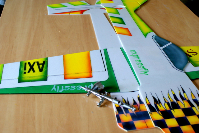

My Suk-X indoor airbrushed plane !
I mainly use an airbrush and I have a few different types of paints, now adays car paints are non solvent and can be used but take care and always do your test peice first.

Quote from: "Richard Boyd"
That looks great......

Cool paint job Richard    :clap:
Are you using Auto Air or Createx
Peter K
Painting Foamies ???
« Reply #8 on: November 11, 2010, 19:57:43 PM »
Hi Peter on this plane I used Createx, and some acrylics I got when in Lithuania last year, sorry I donot read Russian lol.
Createx is a super paint and so is tamiya.
