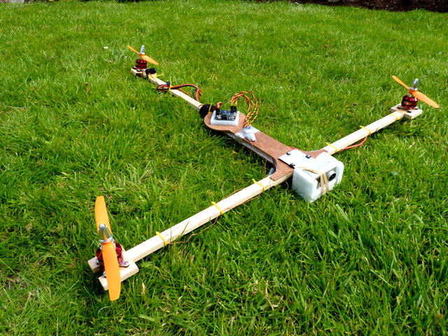

Hi all, well I have made a first step toward FPV by building a Tcoptor.
I have had only 2 flights in windy conditions, resulting in  2 crashe    :shock:
This incoming week looks like it will be calm so I intend to do abit of practise flying and try and get used to coptor flying.

Hi Keith , this is not my design, the motors are 120 degrees spacing from each other.
I have tweeked my setup abit to try and make the coptor steady in flight.
I used higher KV motors swinging smaller 8x4 DD props.
The frame cost £4 to build , I am getting like my Scotch friend  :lol:
I decided on a T coptor as I wanted some nice video shots with no motors showing.

Hi Keith , I used 1100 KV motors with 8x4DD props, the norm in tricoptor would be 750KV-950KV motors with 10" props.
I was working on the theory that this would make my coptor smooth for slower style of flying.
I think it works    :?:
Now for an interesting observation,
I have 7 x 2100 3 cell packs.
The older packs are well used and I get about 3mins flying and then the coptor looses its steadiness, it goes completely out of trim.
When I use a new pack the coptor is rock solid for 6min .
I now need to buy several new packs. broke again
 :wink:

It seems you’ve come the same conclusion the author of the article I read did: For better control, small fast props are better than slow large ones.
Re Your older Lipo’s. I’m wondering if, being older and less able to hold their voltage under load, whether  they might be adversely effecting your gyro :?: . (Assuming that you're using a gyro that it.)
