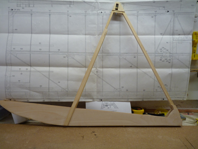

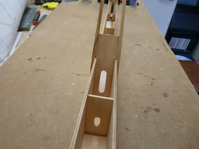

here is what I have achieved so far,
The main fus is almost finished,

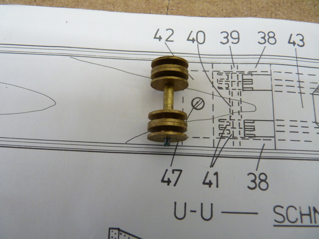

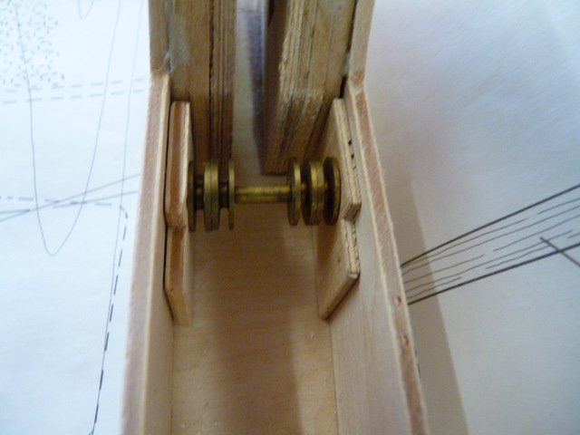

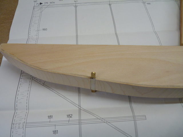

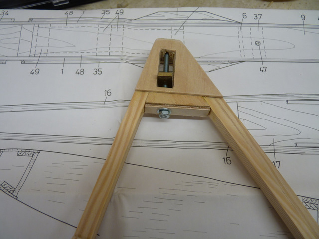

Brass fittings have to be cut ,drilled and shaped.
Wing wire tension adjuster, pity it was not a brass bolt !

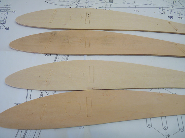

Center wing ribs,  as you can see the outer guide lines are easy enough to cut using the ban saw, but then when you have exact center holes to cut out it become a pain and time consuming.

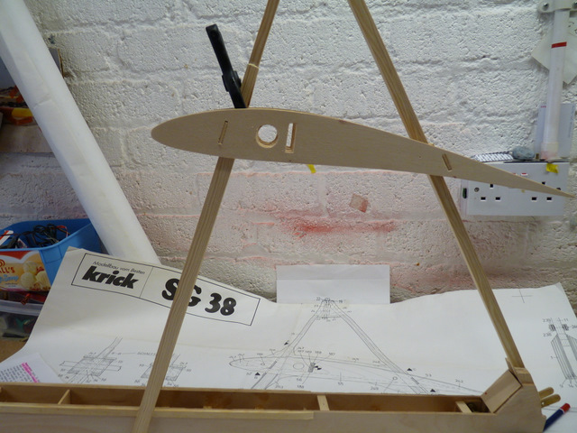

Center panel dry fitted ! I have to return to the main fus at a later stage

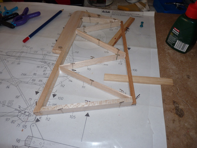

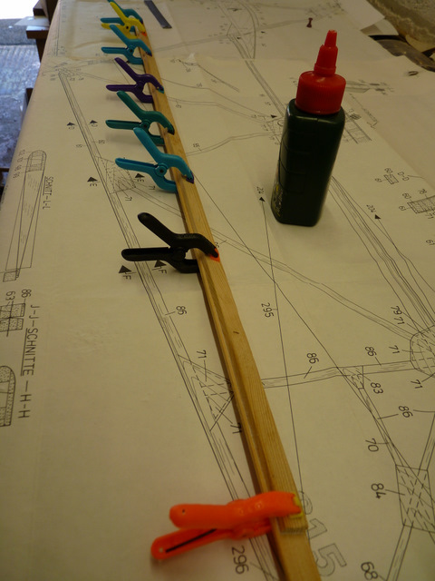

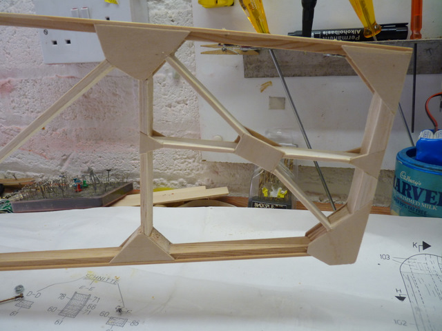

Tail boom got started yesterday,
Spuce top boom halves jointed for extra strength
Frame on the plan
Cross section strengtheners and gusset are all cut sanded and fitted.

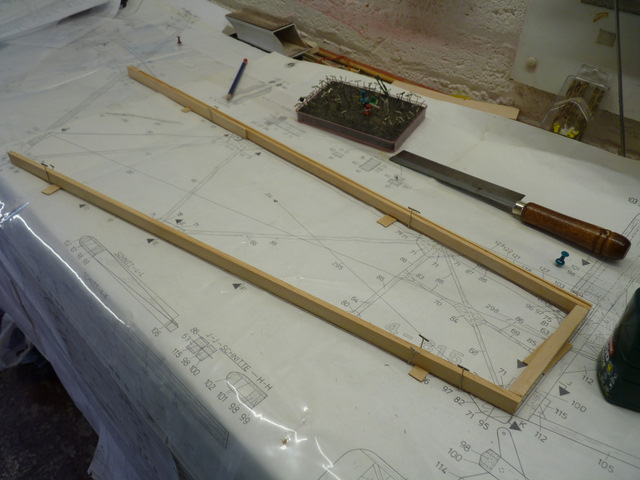

« Reply #9 on: August 13, 2011, 19:57:39 PM »
Made a start on the rudder today, for such a small part there sure is alot of bit to cut out and glue together.
