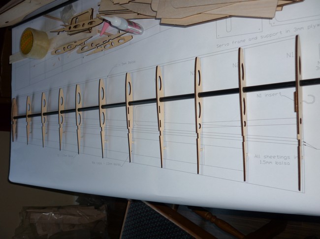

Fred question, I have no cardon tubes, therefore could I use Aluminum 10mm tubes for the wings, the 1m tudes are 50g each, also how did you join the wings to the fusleage??

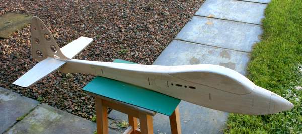

Half day today, so with the sun beating down, wow!! I got the fuselage sanded down on the belt sander, so next comes the wings tonight.
Fuselage ready to cover
« Reply #36 on: October 25, 2011, 18:03:12 PM »
looking good john  :clap:  :clap:

Ok, so, for the spar, I have to admit that using aluminium went into my mind at some stage... I'd say, why not!
After all, this is a prototype, so why not trying! Just don't crash the thing, you might bend a wing!  :lol:  :P  (well, no, I would be surprised!)
To hold the wings, if I remember, all is on the plan  :?:  But as Andrew said, the design use a hook and rubber band (good old fashion!).
In N1, you have to glue N1'. The hole in the middle, is where you screw the hook. Holes in N0 and fuselage should align to allow to put the rubber band (should have plenty of access through the canopy. Designed the shape to have maximum access to the radio  :D ).

I have went with the carbon 10mm tubes, which I got today. The Aluminium tubes required epoxy for fixing ribs to much work and added weight to the wings. So hope to get back to the wings tomorrow night and over the weekend, and get it finished by the end of next week, fingers crossed.

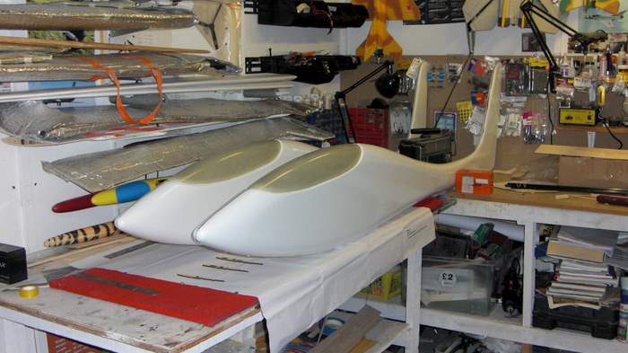

By the way Fred, look what I picked up today, two big sexy ladies */~# 'I mean glass fuselages'
Can't wait to get these big models onto the slope!
« Reply #43 on: October 26, 2011, 22:04:53 PM »
Look like a really nice finish on those John....nice job :clap:  :clap:
