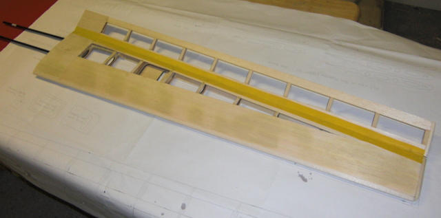

I went with the 10mm carbon option on the main spar and used the 10mm aluminum on the back( the model shop had only 2x 10mm tubes instock.
A little glue and all the spars are in place
The wings do take time to build, however you must be careful to get everything straight and level for maximum performance in flight.
Starting to sheet the wings in light balsa
Oneside of the wings finished
Not much done tonight but I should get more build time tomorrow and maybe get the wings finished.

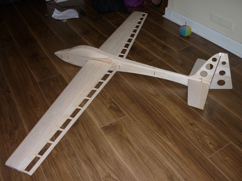

Hi all, well I managed to get the wing finished today and sanded, already started the next wing, so will try to get this finished for Tuesday evening, then we can get covering and install the servos and control rods. The wing has taken slightly longer than I expected, however with the design used it is both light and strong!
Port wing finished and ready to cover with solarfilm 'colour ????' :?:
I think Fred is ready to go for a test flight, so I will have to get my finger out and get moving.

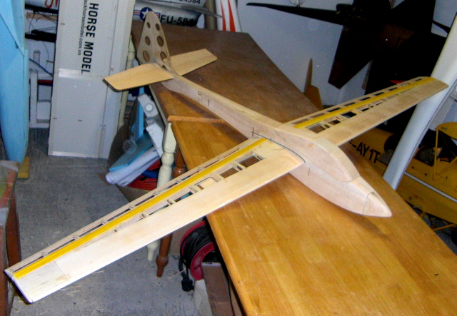

Building part of mine is done. Starting the finishing stage now  :D
Weighted it at this stage (never weight my gliders, but I know the question is going to pop at some stage!), and it came down at 900grs.
Only the covering and electronic to go, so that is going to be a relatively light glider, all without trying to save weight, so it can even be made lighter for all the grams chasers!

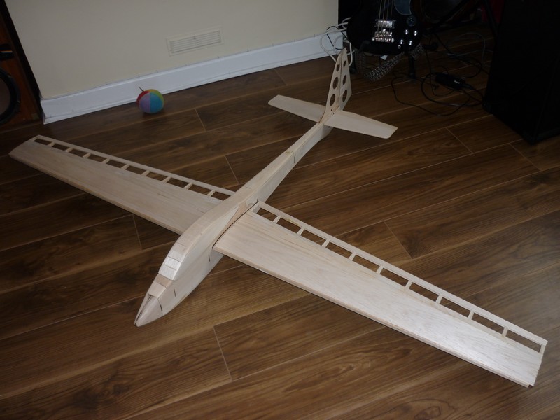

Just finished building the Quark 2m tonight, therefore, I hope to cover the model over the next two nights and install the gear. Weight at present is 1.5kgs 'dry'
Quark ready for covering.
Could have her ready for test flight Sat or Sun maybe??? :?:  :?:

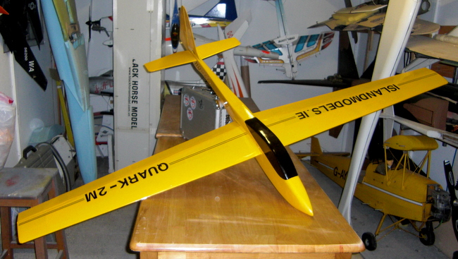

Well just finished covering the Quark tonight. I have kept the graphics simple until I test fly the model, then I may go crazy with the design :roll: Just need to install the gear and balance the model, by the way Fred, what is the CofG, not on the plan??
Quark 2m ready for test flight can't wait to get her onto the slope!
Keep you all updated how she flys!

This is one of the prototypes designed by Fred,that Richard, myself and Fred will be test flying soon. Not sure if this version will be available as a kit (all wood), that will depend on flight performance, if it is to be added to the Islandmodel's portfolio of short kits.
