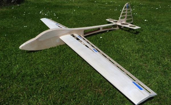

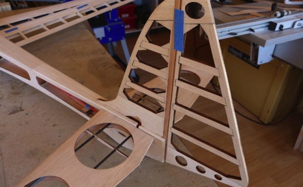

Hi All
Thought I'd post yet another Quark - this time from across in Scotland  :D
I'm lucky in having my own homebrew laser, so cutting wasn't an issue  :)

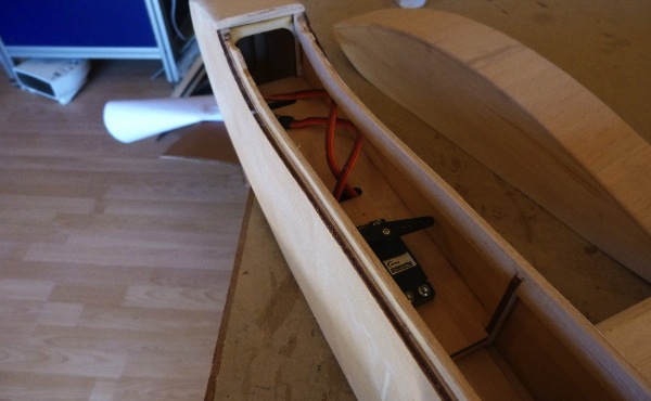

Used liteply for the fuselage sides rather than 5mm balsa, so I'll see how much lead is needed in the nose :-)
Only had a couple of minor structural issues during the build, the servo plates were only attached front and rear on the formers - consequently, they were really weak at the servo cutout and just cracked when installing the screws (there was also a lot of flex when the servo operated). I changed the design to have the servo plates the same width as the fuzz - also stops the fuselage flexing where it's gripped. The other one was the vertical stab, the top half of the stab is held only by a couple of small areas of horizontal grain - I added a 6mm spruce spar at the fin TE which ties in to the end of the fuzz.
AUW is around 960g naked - I'll post some more pics when covered.
Great looking plane - thanks for making it available - good job!!
BTW, anyone struggling to get carbon tube etc in the UK - I got mine online from Woolmer Forest Composites ...
https://www.woolmer.co.uk/
Not cheap, but nicely made and well packed - real pultruded too - not black chinese dust and epoxy :-)
Cheers
Neil
 :lol:  :lol:

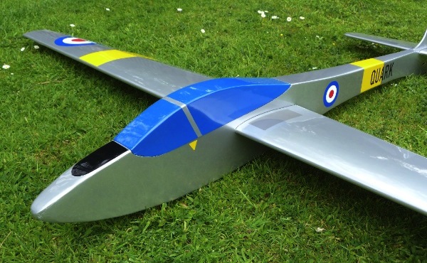

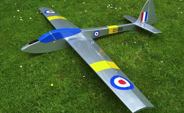

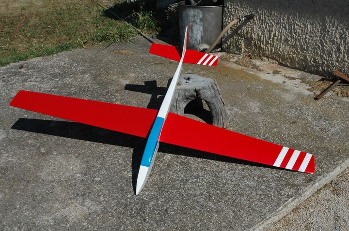

« Reply #370 on: May 31, 2013, 15:47:39 PM »
Thanks for the kind comments!
Eventually got the machine covered - film courtesy of Mr Cod - seems like good stuff for the price. I've covered the underside in white with the intention of putting big dark blocks of colour on.
Pix attached, always was a frustrated PSS'r  :lol:
With any luck, should get it out on the slope this weekend.
Much prefer the idea of a wood spar - aircraft spruce is much cheaper than carbon tube !
Cheers
Neil
« Reply #371 on: June 05, 2013, 12:40:42 PM »
:oops: Sorry, only see your post now!  :oops:
Anyway, me like it a lot!  :clap:  :clap:
Original colour scheme, that suit it very well on top of that!  :clap:
So, have you done the first flight?  :D

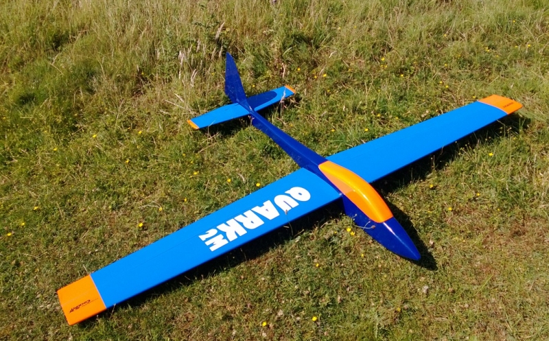

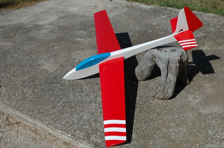

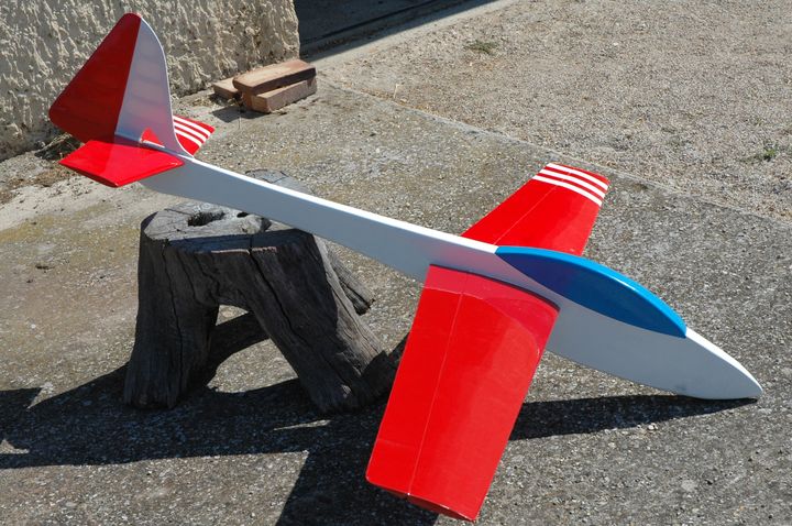

« Reply #372 on: July 17, 2013, 09:37:52 AM »
Another day, another Quark  :D
This time from France  :D
First launches on the flat went well... First slope session this week end  :D
