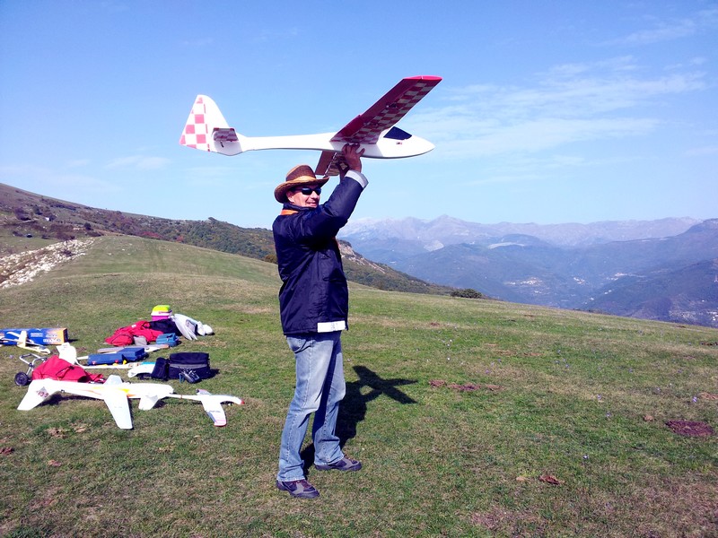

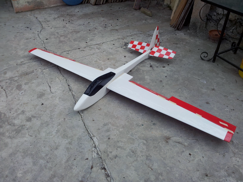

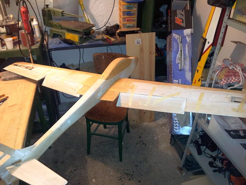

« Reply #339 on: November 02, 2012, 13:13:50 PM »
Received from Italy today, from Pierpaolo  :clap:
First flight went well, and love it  :D
You can see that he splitted the ailerons to have the flap option.
AUW is 1.4Kgs despite the modifications  :clap:
More photos to come  :D
« Reply #340 on: November 02, 2012, 15:08:57 PM »
It's a very good idea, maybe i do the same for mine.
« Reply #341 on: November 02, 2012, 15:24:50 PM »
Yeah, the original plan I made had flaps.. But them removed them.
On mine, I don't see a need for it, as you really can slow it down without stalling, and in all other cases, ailerons down is more than enough.
If I find the original plan, I might put it to download. Very simple change to do.
Might also get rid of the carbone spars, and use strip wood instead  :?:

Another photo of the Italian flapped Quark  :D
Pilot said that landings with full flpas, is like landing an helicopter, no speed, and no stall  :D
A very good mod for the ones that want to do it  :clap:
