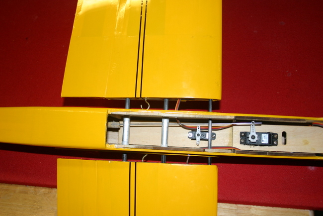

O.K. the Quark 2m is ready to fly. I used the Cof G you suggested and it balanced with a battery and 12oz/340g of lead.

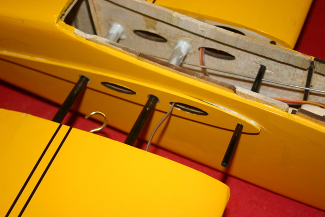

Here is a photo of the changes I made to the wing joining system.
If you changed the last rid on the wing, and put the cable hole at the back i.e. ( the reverse of the present design), then we could add the hook in front of the front wing spar, which would hold the wings together better. I could not do this, due to the fact that I had already added the hook brocks and covered the wings, the rod added to the front, was a quick fix solution.
When I talk to you next Fred I will explain it better, hopefully soon!
The AUW ready to fly is 3.8lbs/1.7kgs
« Reply #77 on: November 07, 2011, 23:12:40 PM »
Thanks a mil for that John.
I'll modify my plan to my first idea tomorrow. I'll put a screenshot here.
1.7Kg, not bad at all, that should do it fine!  :D You might even remove a bit more lead from the nose after the first flight.
