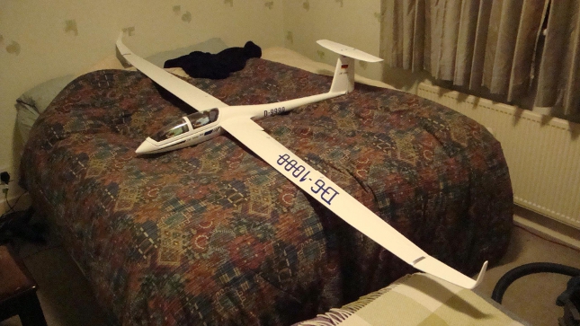

       New glider nearly ready to go. It's a hong kong special 2.6m dg 1000. Finish is not bad (some flat spots on wings), covering was excellent on wings and moulded fuse is good. Final weight with ballast (250 grm) looks to be about 1450 grms. Cost was unreal at €100 delivered. Anyone any experience flying this model? Seen vids on utube and seems to fly ok but needs speed. Mine is the version with flaps (has semi symmetrical foreward swept wing).

       Maidened my DG1000 tonight in 10-15 knots, it flew ok, handled the gusts very well. It's certainly no floater and needs a stiff breeze. It felt somewhat sluggish on the controls, perhaps I'm not used to the larger span models. It comes down like a stone when the wind drops and speed must be kept up. I'm semi concluding it's a dog but will reserve final appraisal with more testing.
  On the last flight I was caught short and put it down flat on the scrub,the tailplane caught a bush and yanked the fin sideways cracking the fiberglass at the fin to fuselage point. When putting the model together I did think this looked like a weak spot as it could readily flex with little pressure on the tailplane. Anyway will glass it up stronger tomorrow and have another go when weather permits. I then got some nice soaring with my middle phase, It was a great evening for flying and met another flier whilst there, he was flying a Hawk yes a living one. Great to watch and an impressive regal looking animal.

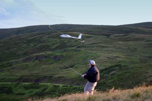

DR1000 on the slope
