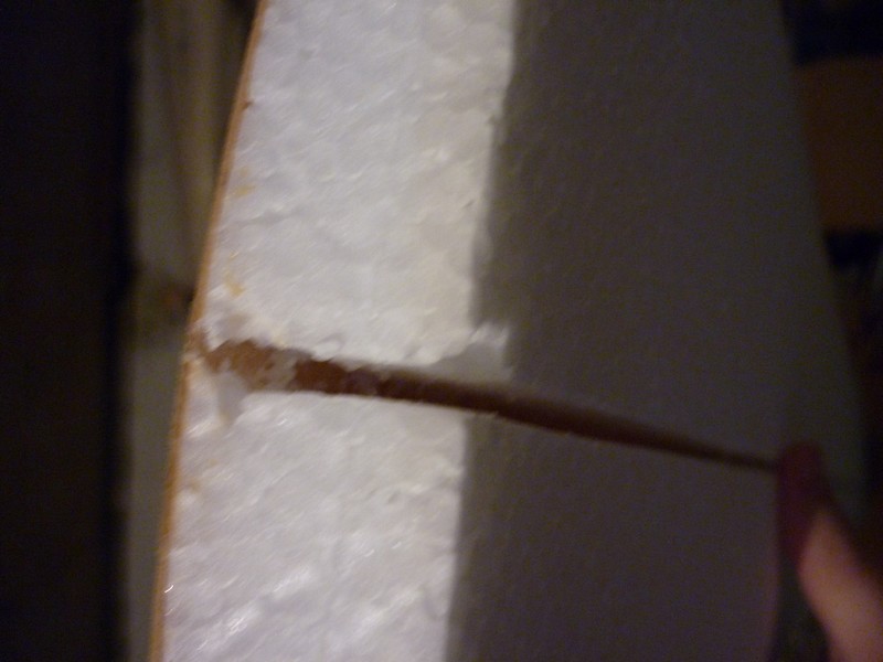

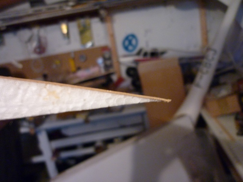

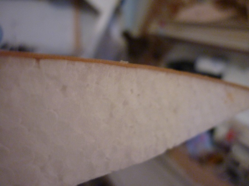

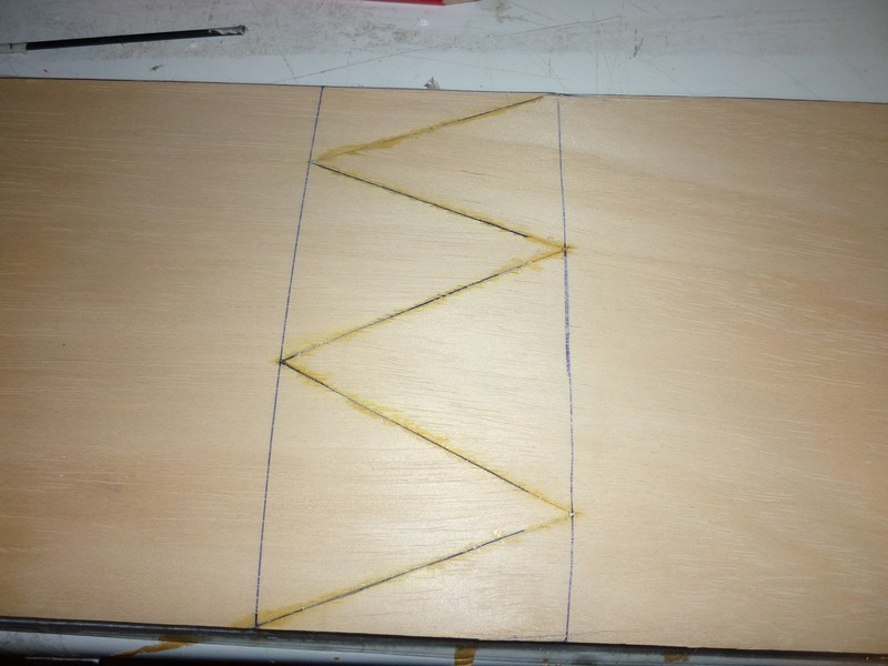

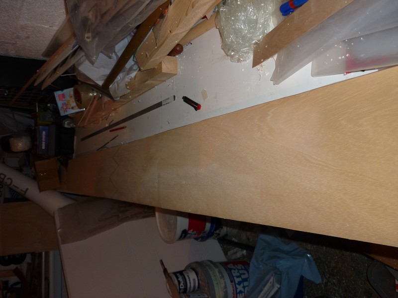

So first, you start with the wing sheeting, the top first. The sheets are linked the usual way for this kind of work, evrything is glued with PU, and bagged for 24 hrs.
That gives you this stuff :

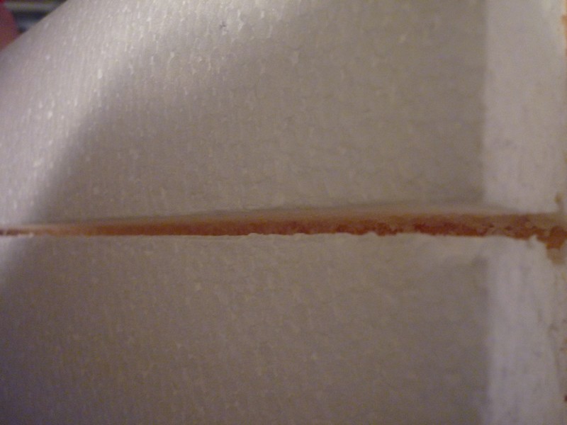

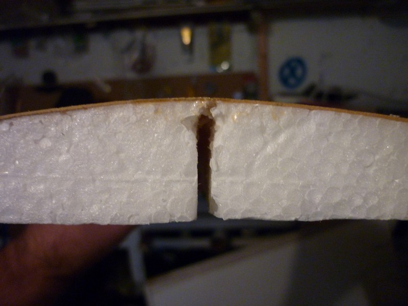

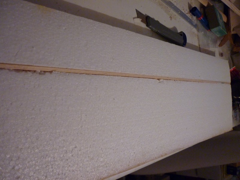

You can see here the "channel" for the vertical spar, before being cut all the way through. This way the profile is not "disturbed".
With a screw driver in my case, remove the remaining foam, and free the slot for the spar
It is very important to do all the work on the wing,while they seat on their foam cores to make sure they are straight!
Like on the mini how to link, the spar is then added, and cut to size.
The spar will be epoxied in place, wrapped in carbone, and everything will be bagged to make sure everything stays where they supposed to be!
