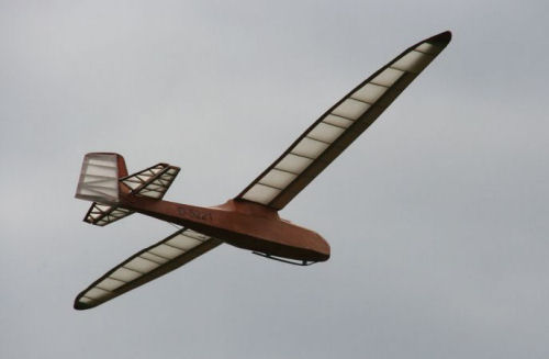

And in flight :
Fly like a dream !
Really easy to fly, and even only with Rudder / elevator, she's really responsive. We tried the roll (well, you need altitude !  :wink: ) and the loop.. And that's pretty much it !
After that, slow low passes to admire the line of the machine.
