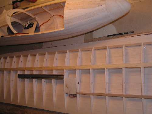

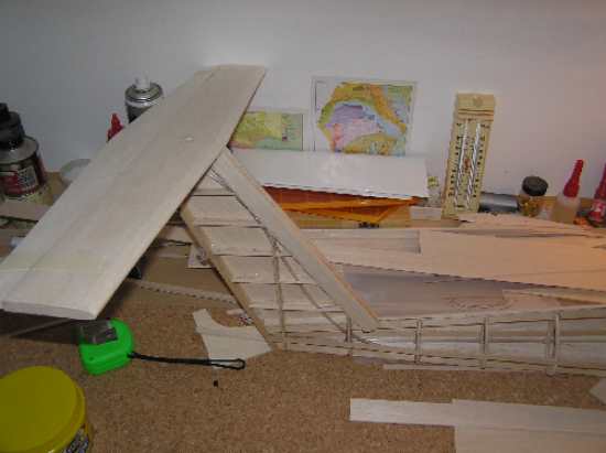

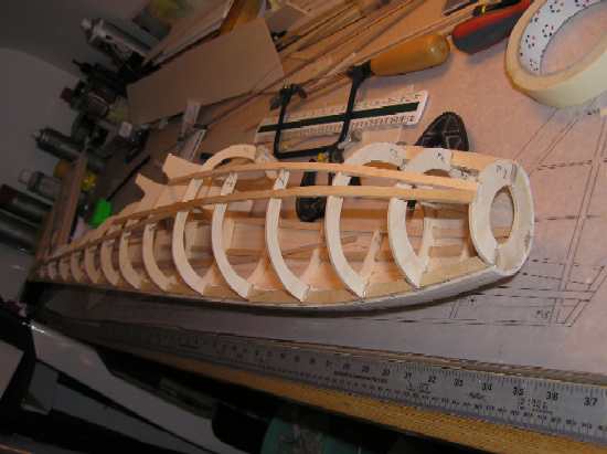

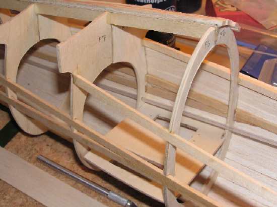

Not really a build tread - I work too slowly for that!  But a progress report on a Pilatus B4 build from an old Mike Trew plan.  As you can see from the photographs, the fuselage is coming on.  Half planked (that took a bit of time!) and currently I am working on the controls before planking the rest.  Made the tailplane last weekend - it is bolted on.  As I have changed the wing section I want to be able to alter the longitudinal dihedral as I suspect that on the plan is too high for the HQ25/12 section I am using.  So far so good - but anyone else building from this plan, watch out for F11 - this does not have the correct profile!

Looks very good.  :clap:  Hope to get going on mine again soon. I got the wood, piano wire joiner and airbrakes from Topmodel with the DG-1000. All i need now is the motivation. :lol:
I put F11 in and didnt notice until later that it was wrong. I had to glue another piece of ply to it to get it to the right profile.

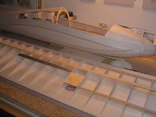

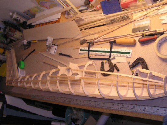

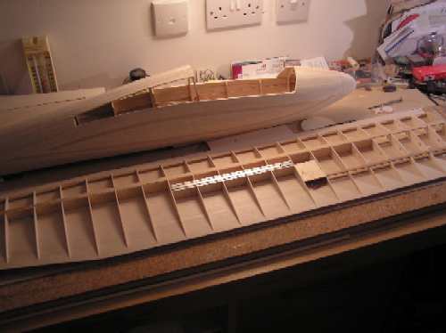

Right - seems with this poor weather quite a few of us are busy building.  Here then is an update on progress with the B4.  Fuselage is mostly planked now and servos/controls installed.  It looks much better now I have added a nose block!  Currently working on the first of the wings - fully sheeted structure so trying to get the innards sorted before adding the top sheeting.  The idea is to build both wing panels minus the top sheeting so that I can sort out the joiners/dihedral/alignment to fuselage. Constructing a canopy is looming so any advice much appreciated - not done this before. Also  would like to make a hinged metal (aluminium?)frame for the canopy perspex - how should I go about this?

Thanks guys. Yep it is amazing what you can do with wood - time consuming but satisfying! I'm quite impressed with what complex shapes and curves you can create with a bit of effort.
Pilatus B4 build
« Reply #10 on: April 01, 2008, 21:06:28 PM »
Well, I can't disagree with that !  :mrgreen:
Sorry I haven't answered your question about the canopy...
Well, with balsa locks, you can make a plug and then vaccum form the canopy (http://www.gliderireland.net/vaccumforming.htm) but manually is also fine (use a 2 liter coke bittle...)
I have the vaccum box if you want to borrow it ! (and clear plastic too...)
For the frame, I will do it in brass tubes and soldered. Easy to form in shape, easy to solder too (see the frame for the 1/3 scale Ka3..)

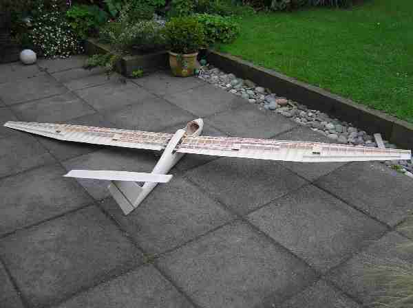

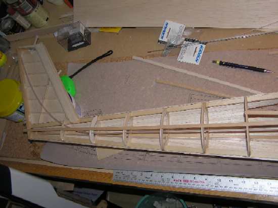

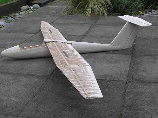

« Reply #11 on: August 29, 2008, 17:08:41 PM »
An update on progress - or a couple of photos anyway! Actually beginning to look like a glider.
